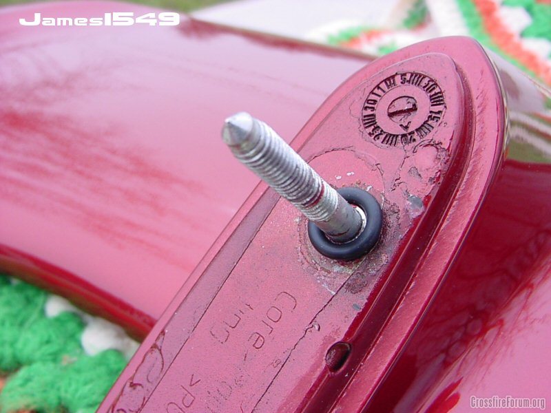

I have my spoiler off -- I'm doing some custom body and paint.
To answer your question; yes - there is a small o-ring around each of the bolts that protrude into the hatch. You can get these at any decent hardware store.
Mine had a small amount of rust (very minor) on the bottom of the mouting base of the spoiler. But we don't get much rain here in So Cal and my SRT6 is always garaged.

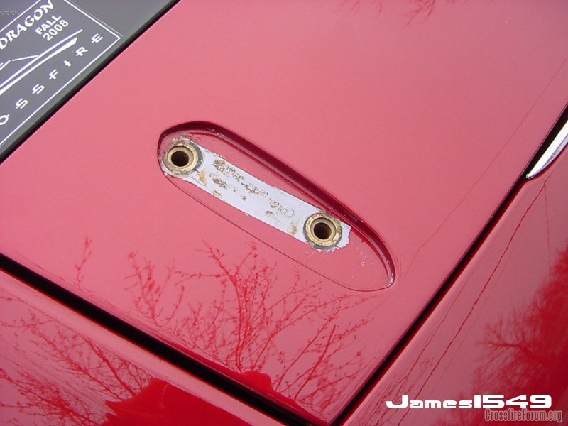

I would like to see pics of your car with the added wing on top of the original wing. Curious if it is aftermarket because an SRT wing wouldn't sit flush on a flat panel. I see your USER GALLERY is empty. Does your wing still come up when you hit highway speeds?

James1549
I now understand the problem. Your pictures were great. The spoiler I have is indeed the whale spoiler and the bottom of the spoiler is the same. The difference and my original confusion is in the mounting. It appears on the back of your vehicle there is a recessed area into which the spoiler pedestals mount and the reason for the Orings. Mine is mounted on the top flat surface of the base coupe and had holes drilled through the coupe's spoiler to mount the large spoiler. As a result the groove/recess around the pedestal base creates a open distance between the top of the original spoiler and the outside "lip" of the added spoiler. They had originally cut a piece of cork to fill the gap around the perimeter and I mistakenly thought there was a gasket that was missing.
And now I know why one of the bolts had an Oring on it.
They did cut the bolts so the nuts wouldn't hit the hatch under the orginal spoiler. So now I need to figure out a rubber gasket similar to one that goes under a facuet or something like that.
