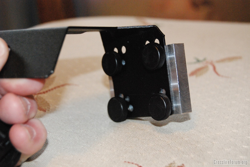

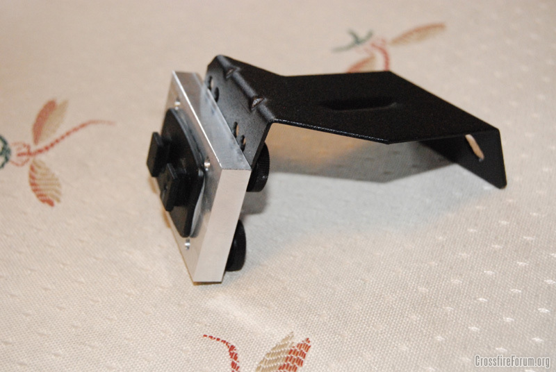

Rudy,
I think this will work..... I'll update in a couple of hours when it is dry....

Originally Posted by MikeR
Rudy,
What is this foreign object, warp drive transducer?
Old Apr 12, 2010 | 09:58 PM
MikeR's Avatar
Posts: 5,180
From: North Plains, OR
Default Re: DashDaq Install
A couple pics with it mounted to the panavise mount..
I added the thumb screws to the bolts to make it easy to install/uninstall.....
My guess is a quick disconnect for dashdaq?

MikeR's Avatar
Posts: 5,180
Yes. The one that comes with it is for the suction mount. I just 'adjusted' it a little.......
Very nice, i like the way you think.
