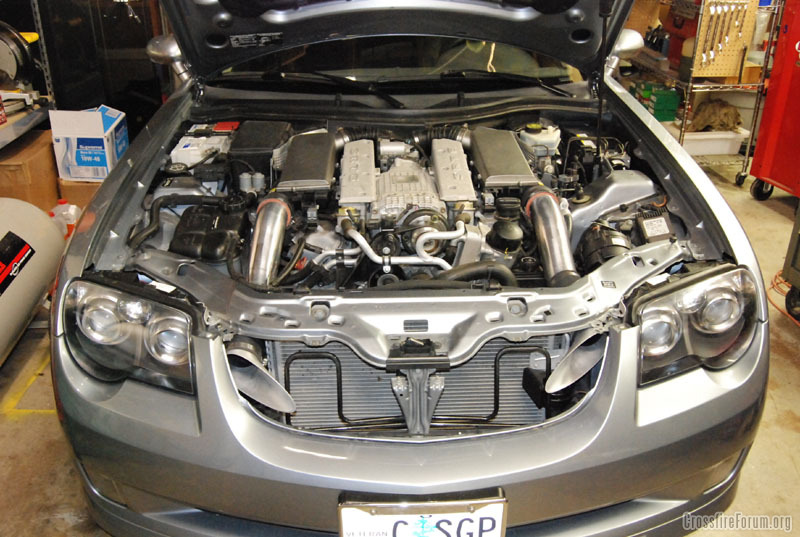

Just thought I'd share that earlier this week I ordered a set of the "Devil
Horns" and the tubes to go with them. I really like the look of these and
boy to they really give a "bad a$$" look to the car. Just wondering though,
with those "scoops" can I expect to get a ram air effect that would
increase my boost?

wont inc boost but will force more air thru the s/c . i have the setup on my 32

Coyote, you will get better air flow if you open up your air boxes so they dont restrict the air so much... SL55 boxes and Y would be the best if you want to keep the stock look......
Looks like this.....

mike if we could just get the m/b center piece to fit!!!!!!!!!!!!!! then i would add the 55 boxes. already have everything else!

Mike, you are right about that. I've already got the SL55 intake installed.
Been running that mod for about 2 years now. Now, I want to tie that
in with the Devil Horns. Those things look awesome in your engine bay.
Not sure when they will be delivered, but they have been ordered and
paid for. Can hardly wait to get my fingers on them.

boost will remain the same until the speed of the compressor is changed. the inc in air to the chamber is the one side of the a/f ratio not boost. by using the horns your adding colder air and more air than stock. so in theory you should be leaning a bit if you havent tuned
i wrapped my tubes with black exhaust wrap to keep the engine bay heat off them. before the wrap you could literally burn your hand on the tubes,(mine are stainless steel) after the wrap you can hold them all day they are just warm toi the touch. 10ft should wrap them properly

Actually a better flowing intake most definately can increase the boost. Not very much but less restriction pre-blower equals more air out the other end. This has been datalogged by several poeple.

to a point it can, maybe a few tenths of a pound, maybe a pound or two on a really really cold day.
on turbo systems, less restriction pre turbo = quicker spool an slightly more power, but it doesnt increase boost for the most part (wastegate) but with a supercharger you're limited by the pulley.

fellas i stand corrected! even a tenth is still a gain.

Thanks for the tip on the wrap. When I got my tune back in December at
the Atlanta session, my a/f was quite good. I was showing a max of about
12.5, with normal of about 11.8. I think I should be good, but I definitily
want to get a session on the dyno soon. How's the progress on getting the
tune and track day set up?

infinite for my use of the devil horns wasnt a "ram air" effect but rather to get the cold air from the front of the engine to the t/b without losing my m/b center piece. im not able to use the dual cai on my 32 due the difference in the grille area. so to enlarge the oem openings and get more air into the t/b i modded the oem boxes added a sl55 y splitter and the devil horns.
