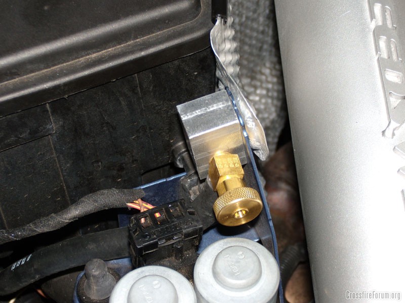

Well I finally got tired of looking at my NW fuel kit sitting in a box on my work bench so I spent about 5 or y6 hours installing it yesterday and finishing up this morning. I mounted the solenoids, relay and ZATV under the battery tray (no see 'em now) and brought the adjusting valve up in front of the ECU box. Still have to machine a bracket to hold it nicely. Tie wrapped for now.

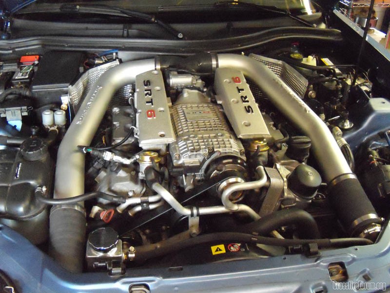

Here is a pic of how/where I mounted the boost adjustment valve this morning and the engine bay.
Yes, I do need to clean it.....
