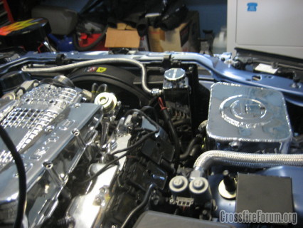

Originally Posted by amx1397
I know it looks dirty but the paint peels off because it gets so cold,this is a 3 1/2 gal. tank.jim
Nice tank, that is a lot of volume, custom right?
IIRC, Jim posted a video of that tank flowing with his killer chiller hooked up. I couldn't believe the flow; it was like a swift babbling alpine stream.

Posts: 6,714
Likes: 454
Default Re: Intercooler tank
Temp Of Water In Tank After The Intercooler Video by amx1397 | Photobucket
here is a video of my tank and the temp low temp from the killer
the cab has the OEM ac unit . and it gets cold in the car. then i tied into the high and low AC lines ,set the killer up below the front bumper brace, added the water tank, and added 1/2 lb of freon jim
there are more videos just go to the next one

Originally Posted by velociabstract
With the separated circuits and connected circuits the maximum IAT temperatures on the road course are the same as far as I can tell.
Les
Interesting. I've never been a fan of the principal of separated circuits unless your wanting to run different coolant/wetter etc. The leaking intercooler issue you mention adds another dimension to the design as well.
...........So when your WOT and your cooler is leaking- say MAP=>16psi - it pumps up your coolant tank/system and then I guess the cap releases at something less than this (even though it's not effectively boiling) - so you get residue/spray coming out everywhere. Wow!
I guess that's one way of confirming you have a badly leaking IC then.
I did have a link to the Beamer PS tank on ebay ~$20 but it's just dropped off my watch list.
Old Feb 18, 2014 | 03:28 PM
dinasrt's Avatar
Posts: 2,404
From: Mendocino, CA
What happened to Les was because he was running a BMW PS reservoir tank like myself. They have an 1/8" breather hole in the cap(vented/no pressure). Obviously it would never have spit unless his CAC was ruptured/cracked. That doesn't make the tank a BAD thing. I like being able to open the cap after a hard run at the track and sticking my little finger in to see how warm it is. You wouldn't do that with the engine coolant system. The only negative that I could imagine is the two separate temperatures and pressure differential on the opposing walls of the CAC exchanger. I think Woody may have talked about this a long while back, and is probably where I read about it. IIRC he talked about an accordian like dynamic that could (MAYBE) be working the already thin/weak metal walls of the CAC exchanger. Is this what is causing the failures, or just speeding up the inevitable? Either way, I really would like to get one of Rudy's CAC upgrades, sooner, rather than later. I believe with his, we wouldn't have to be concerned one way or the other about this occurence.
