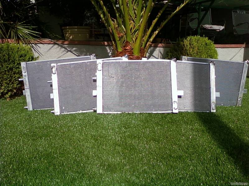

Too bad you missed out on these!
Dual flow Super Coolers that went for $300 back in the day.
you could always build more for 399.95....lol
