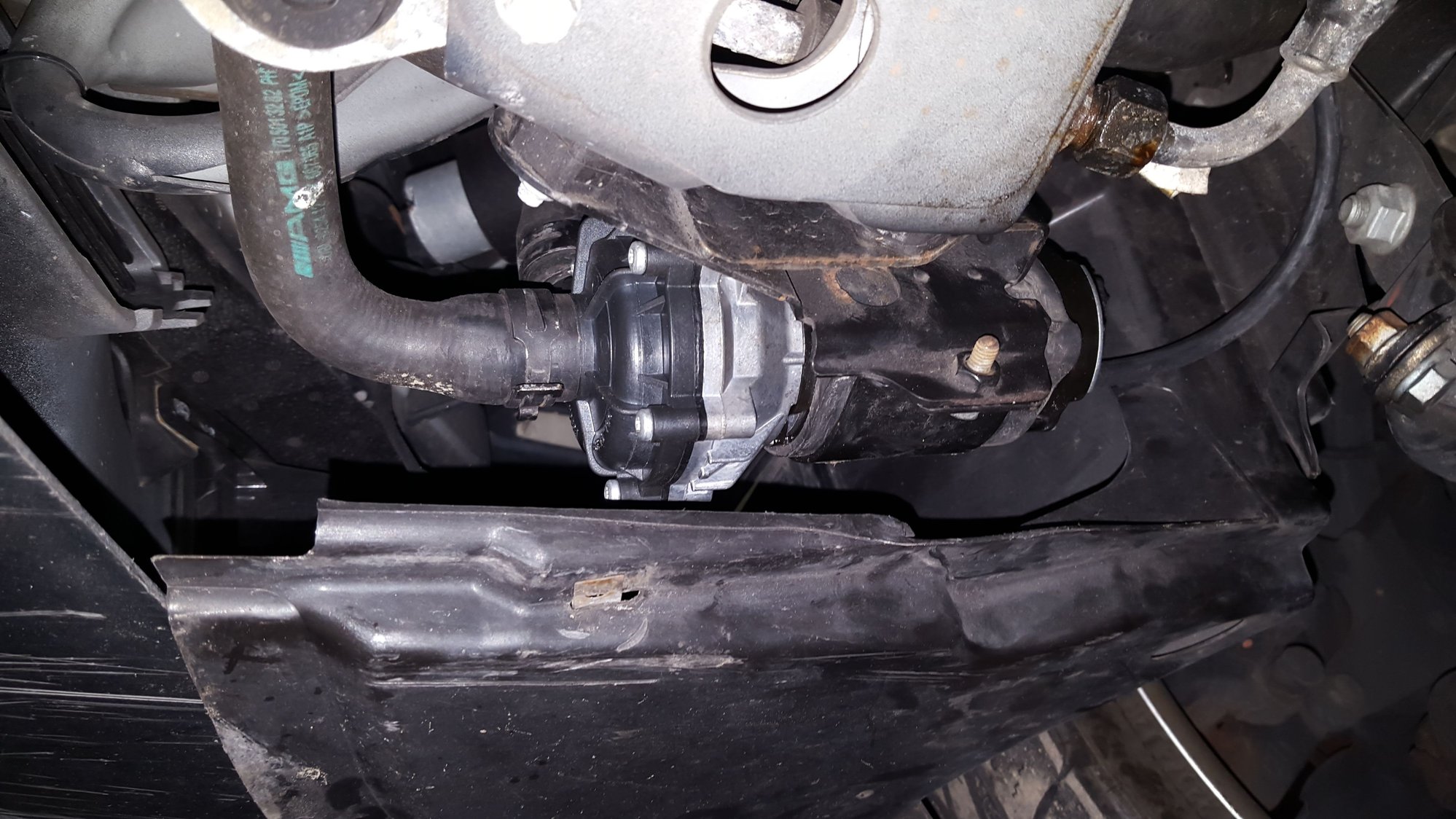

A shot in the dark....does your car have a coolant separation kit? A picture of the area below the overflow tank would be helpful btw.

No. I might add that the coolant I got out of the car was red and not green or blue :l
Its like its not pulling the coolant into that system from the engine side.

take a picture of your engine bay and post it up here please
Sorry didnt get any of the bay just underside. Standard NW dual intake. Everything is stock and leaky valve covers.

Is it possible that the IC is plugged up? I guess you could run water through it with a hose. Or disconnect the return line from the IC with engine running to see if there is any flow.
If there is a build up of crud in the coolant then small passages trap the crud and eventually block up solid.
Blue is the return correct? Where should I disconnect at? Would using some radiator flush even help in with this car? Will our heroes make it out alive? Stay tuned for the next episode......
