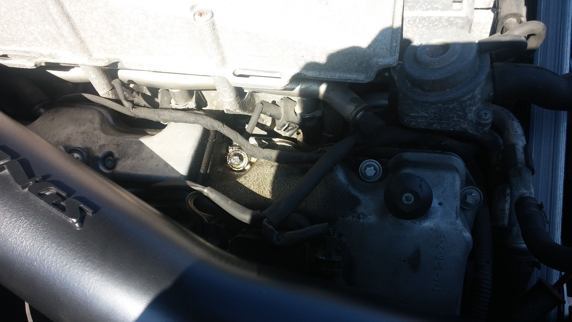

The second surprise was when I went out with a friend that night to pick up a pizza. Got the pizza, turned the car on and the check engine light was one. Popped the hood and the was a slight clicking sound from the passenger's side of the engine bay and it looked like there was a little bit of oil seeping out from what may have been a valve at the side of the engine bay. I'll take a picture tomorrow. Crap...

Looks like a valve gasket leak. Nothing serious. May have too much air for the map flow now. Hopefully teething issues.
That is leaking from the breather valve cover, normal wear item. Your going to have to take them off clean them up and reseal with new sealant. The small covers dont use a gasket.
We could have told you that the srt6 does not use a MAF so you would not have wasted money. They are only for the N/A's. The good news is you dont have a blown head gasket, maybe you just had air trapped in the system.

Hard to pinpoint from the photo, but it certainly appears it's been leaking for awhile, and if not, that needs to be addressed soon. It could potentially be the well known breather cover leak.

I get p0108 only in cold weather over boost, the other is secondary air pump. They would have to take off ur intake manifolds to see if intercooler leaking not dcai
