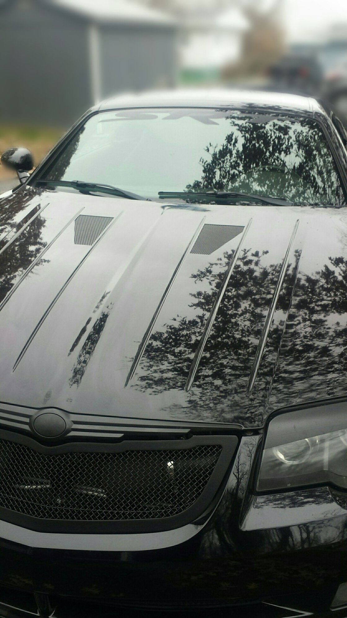

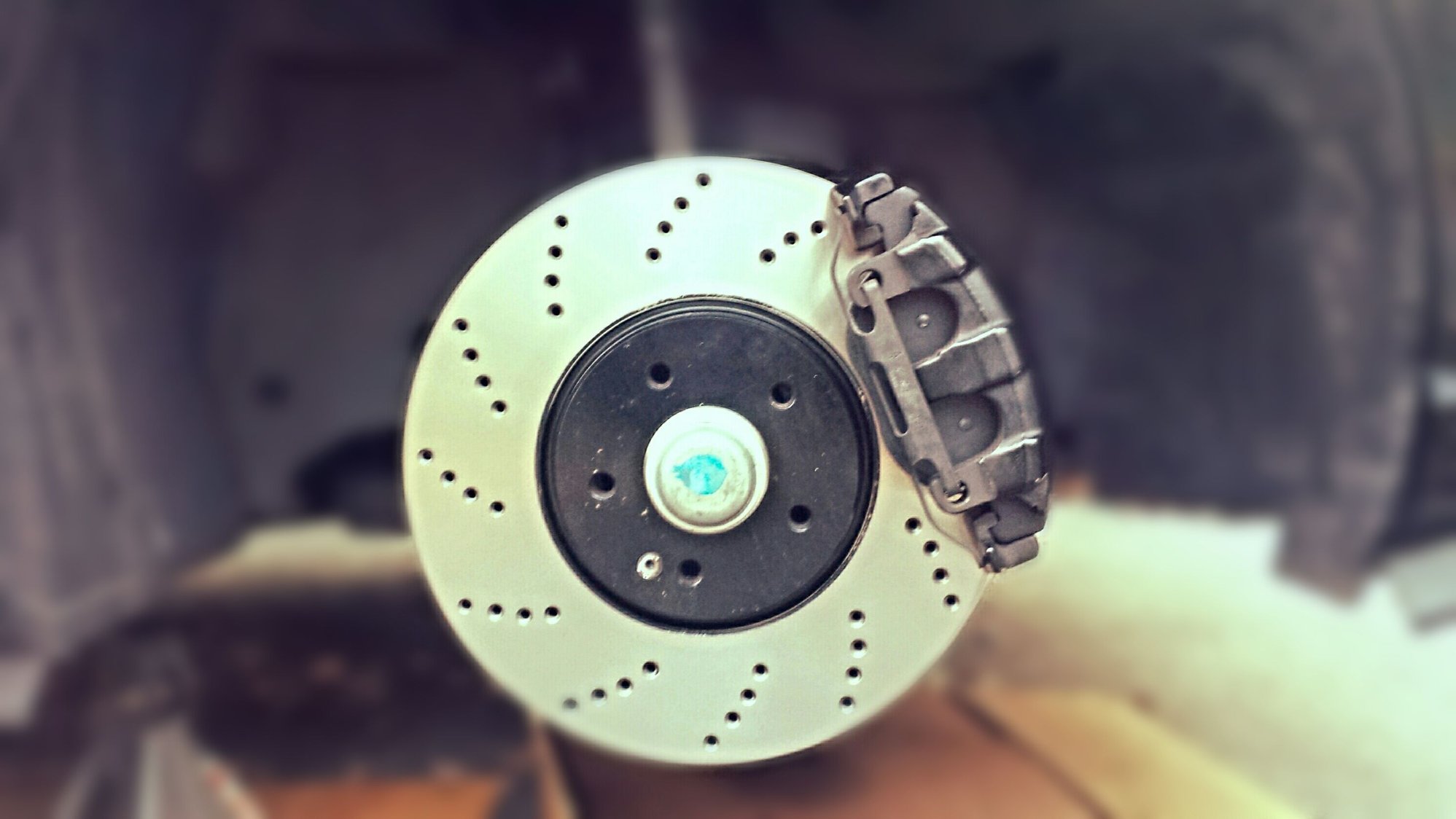

Non related motor mods completed are New Ceramic Brakes and Drilled Rotors, All New Tires, Custom Hood Vents, and Custom Gauge Console

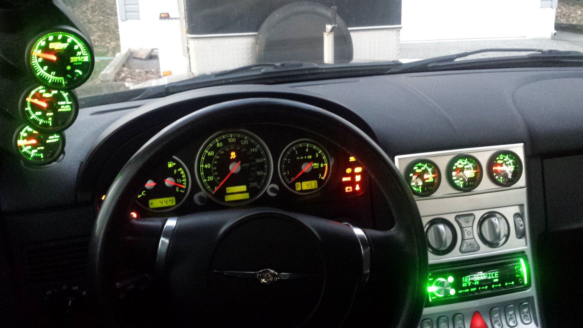

Love your interior setup with extra gauges. How did your create the center A/C vent delete panel? - Very nice…
What are the six gauges monitoring?

Thanks. I believe I did a write up on how I made it. I think it was titled "DIY Custom Gauge Console." But the guages are AFR, Fuel Pressure, Boost, Oil Pressure, Trans Temp, and Volts.
