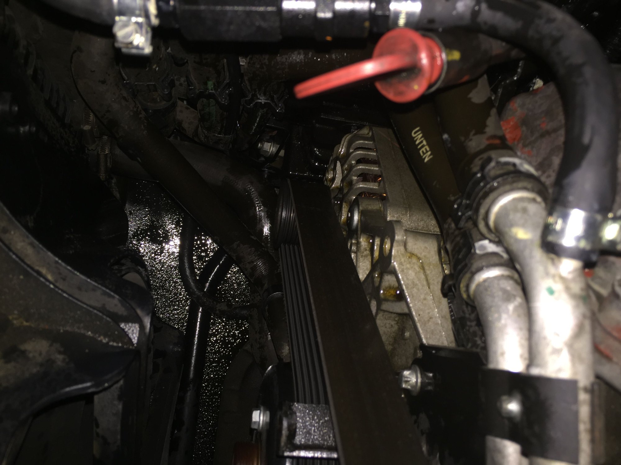

So, was all excited today because I put my Needswings DCAI in. Car runs great, all clearance and connections are perfect. After driving semi normal for most of the day, I wanted to "test" it out a bit, so I ran her hard for about 15 minutes.
I get back to my office 2 minutes ago and decide to re-check everything. Low & behold, the passenger side of the engine compartment is soaked. I don't know what fluid it is, but smells like oil. My valve covers were just done 2 weeks ago. I took a couple pics and in one of the pics I've noticed the dipstick is lifted a bit. Maybe I hit it during the intake instal. Could that be the cause? I also checked my coolant isolation kit and it's all tight, no leaks.
Pics are attached
I noticed the dipstick lifted in this pic

That is a LOT of oil. Start it up and find out, but I'd bet you it's the dipstick.
Although it seems like a lot for a loose dipstick.

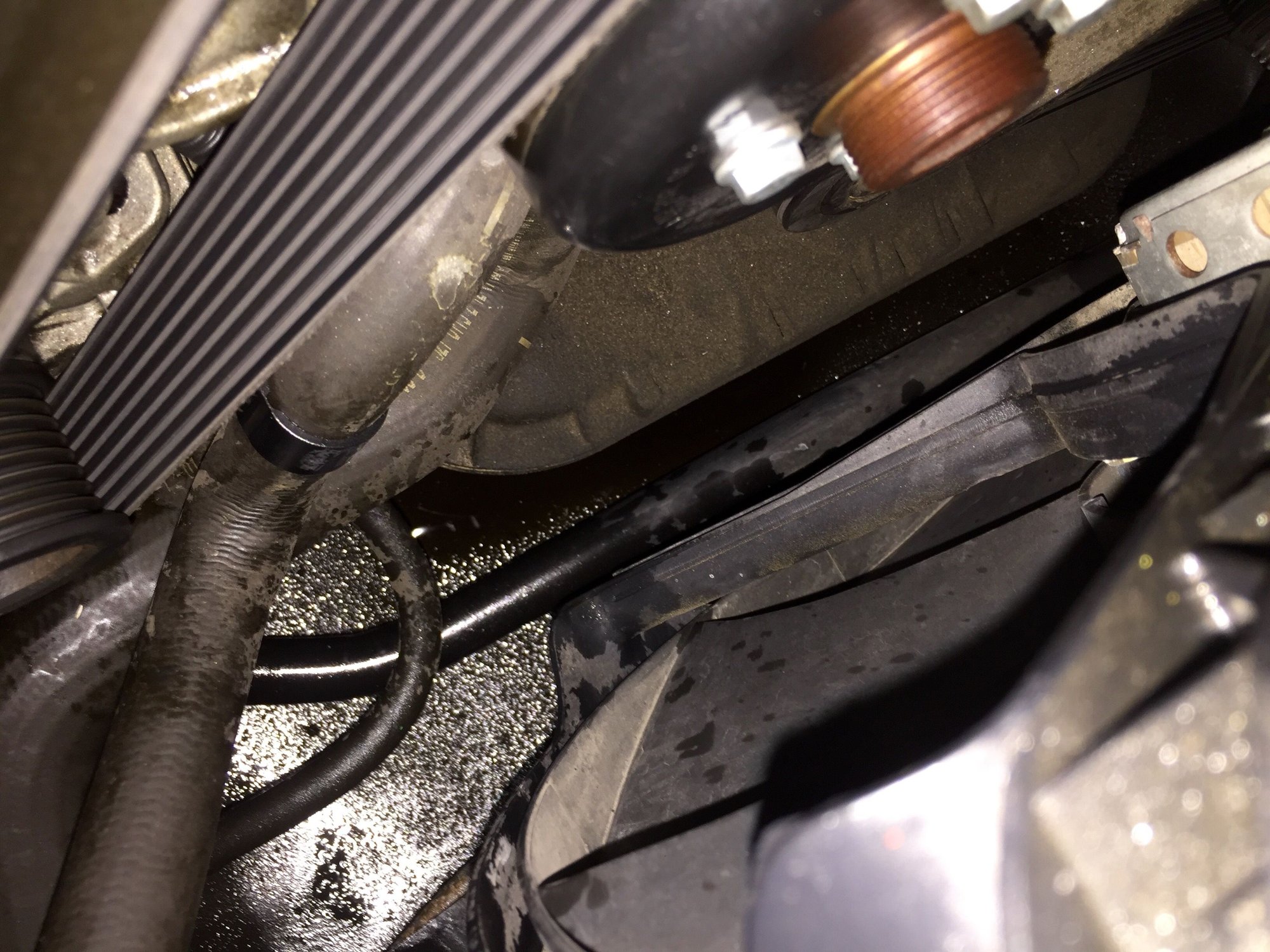

I drove it home from my office (about 4-6 minutes depending on lights) and rechecked. Definitely more oil, but not splattered all over like when I first checked.
Anybody with any thoughts on what I could be
I tried to get a good pic of the puddle on the catch pan.
Looks like I'll be taking it in tomorrow before I leave for the shore.

Is the o-ring on the dipstick? I don't see it.

Dang that's a lot of 'oil'(?). I would thoroughly clean up ALL the existing, and then make sure the dipstick 'o' ring is there PLUS check and make sure the oil filter cap 'o' ring is in the correct slot in the cap. After that, I would check all the upper valve cover areas for any broken or loose lines. Then, and only then, I would start the car and look for a leak. Limit the RPM's, there has to be a source you should have in mind from where the most oil was located before you cleaned it all up. It may be that all that oil was pushed out the dipstick tube (lower end pressure). If the dipstick keeps 'pushing' itself out, you have big troubles (ring or valve blowby?). Good luck!

Years ago I had an oil change shop not tighten down the oil filter enough and had the same thing...OIL EVERYWHERE, plus all the way down the underside of the car.
I would guess it all came through the dip stick, even with those o rings, it needs to be seated in there good.

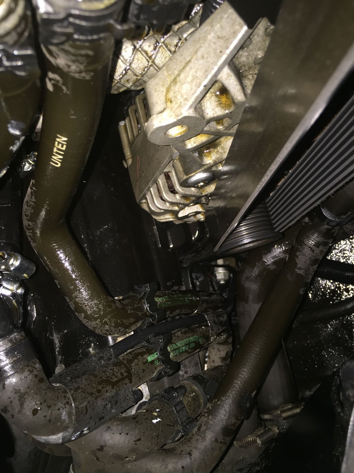

Woke up this morning and the oil "pool" was not any worse. Took the chance and drove the car around my development to see if there was any change or additional splatter while driving, and no change (to my eye).
Brought it to my MB mechanic and he assured me that it was the dipstick. He said the o ring is fine and that I probably knocked it out a bit while installing the intake. He capped off the oil and sent me on my way. The car will sit in my garage till Sunday as I'm going away, but should be all good.
Never would've thought that could shoot that much oil. Apparently with the amount of pressure these cars have, it's definitely possible. He said there's nothing else in that area that could leak oil like that, especially since my valve cover gaskets are brand new.

I would also remove the belt, and thoroughly clean every pulley and idiler, and make sure the belt doesn't have any residual fluid within the grooves.
