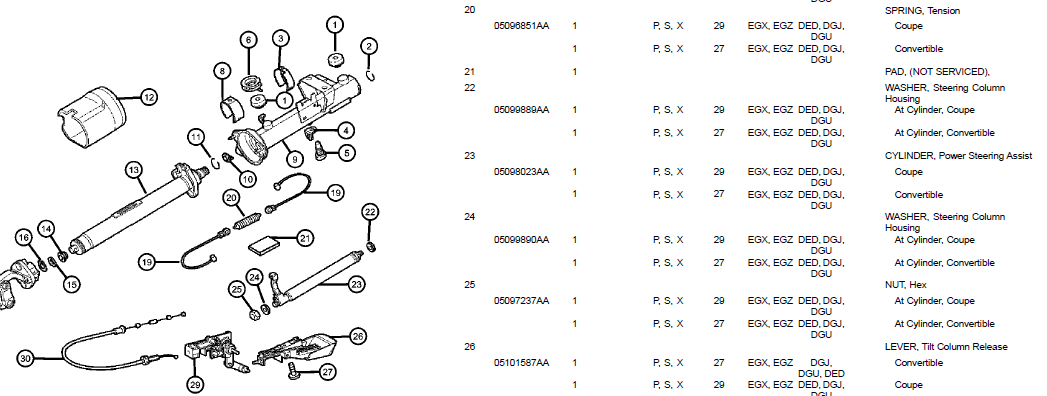

Oh- no got my skreem and ring in the mail last night too dark to see so today I have been reinstalling and putting dash back and I'm almost done and I look down on the floor board and see a 11/2" spring laying there and I did not take any springs off when taking apart has anyone seen this spring under dash before I have been looking around under there for over 2 hours and can't find where it goes ??? Any help please ???
Old Mar 26, 2017 | 03:09 PM
Default Re: Replaceing skreem and ring
Probably goes to the column in/out slide locky thingey.
Nice clean carpet ( ͡° ͜ʖ ͡°)
Part #20 maybe ?
Old Mar 26, 2017 | 03:53 PM
fastfred's Avatar
Joined: Apr 2011
Posts: 308
From: Placerville Calif.
Part #20 maybe ?
YES that has to be it .... THANK YOU AGAIN you do know your stuff ...
Old Mar 26, 2017 | 03:56 PM
fastfred's Avatar
Joined: Apr 2011
Posts: 308
It that spring have to be used I hate to pull this all apert again ??? From the picture I can't tell what it's holding together??
