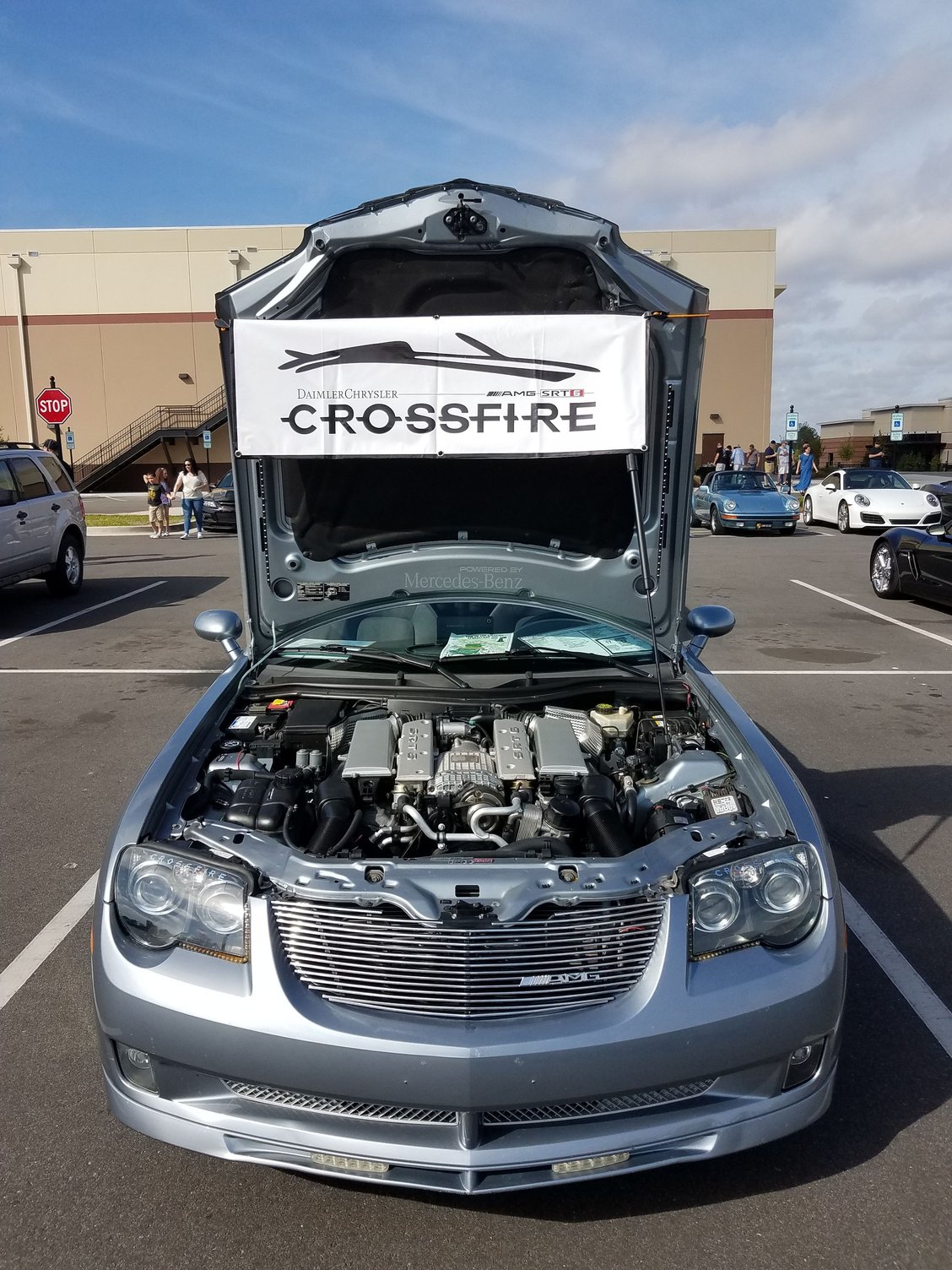

congrats on buying a new toy. I have a SRT roadster, enjoying it fully and I'm past 80. At local Cars and Coffee
