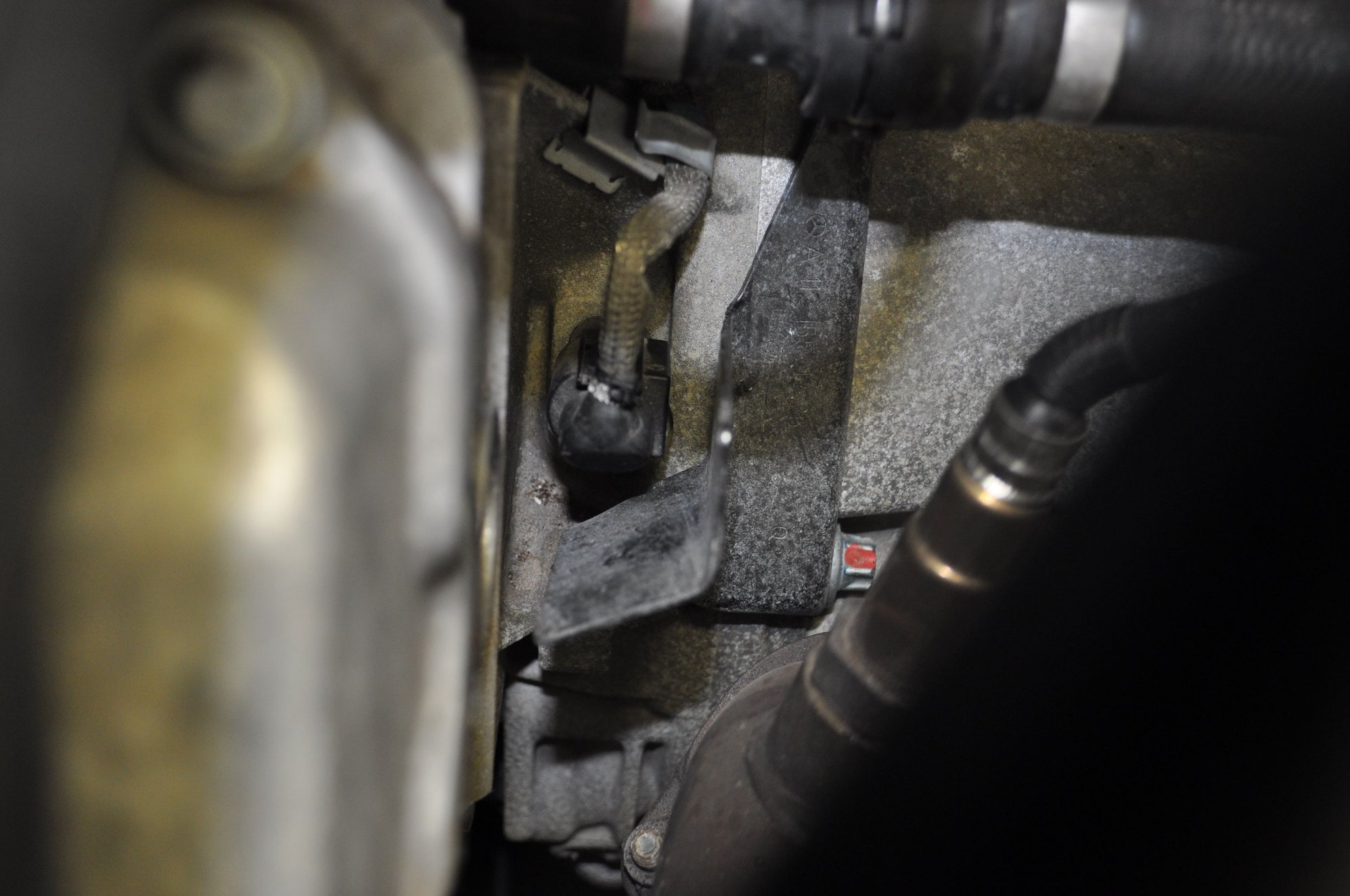

I know where it is but on my 6 it is not visible like it is in Paul’s video.
My set up seems different somehow. There is a fibre glass sleeve that is a heat shield that seems to be the main problem on the CPS wires, this sleeve is large and covers the wires so well that it hides the plug. Looking down all you can see is this sleeve and the red bolt head of the bolt that holds the steel heat shield in place.
I’ll post pictures of it on the NA and the SRT.
CPS on the NA.
CPS on the SRT.

That is a heat shield sleeve given how cps's dont like heat in general and fail because of it that sleeve delays the inevitable failure. I didnt know there was a different from the NA. The NA could benefit from the sleeve as well. I guess Chrysler gave it to the srt-6 to offset the extra heat and is generated down there since it is literally sitting below blower manifolds.
