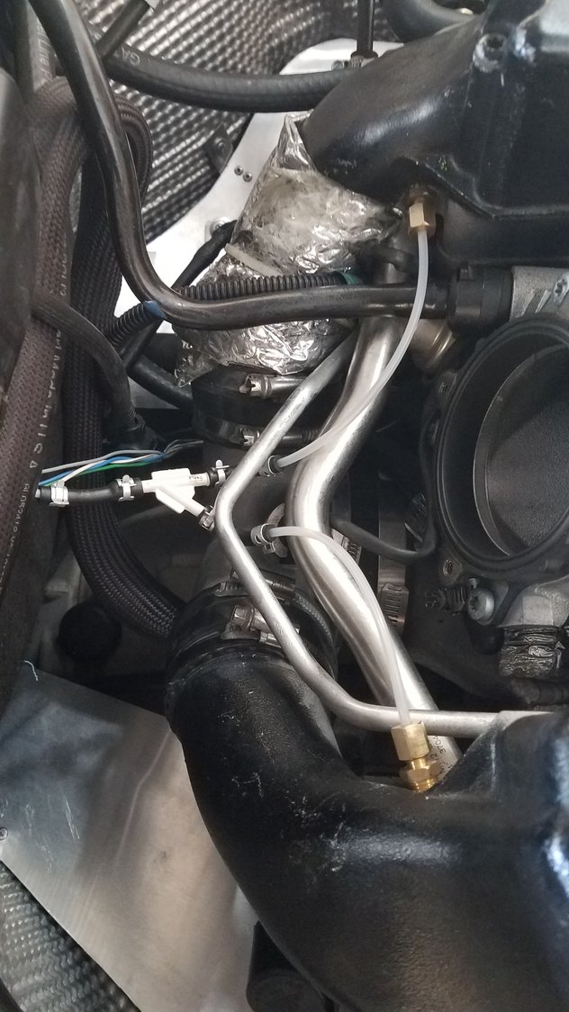

New Split Y from Intake Manifolds
I don't know if any of the SRT6 guys had this problem before but finally, after so long, I was able to fix my boost gauge readings issue. My boost gauge was originally installed on my SRT6 when I bought it. However, despite I upgraded the stock supercharger pulley with a 65mm, the max boost reading I seen is 14 psi at WOT.
After reading a couple old treads I find out that if the gauge fitting is installed in just one of the intake manifolds, I would get partial reading of the boost readings out of the charger.
So, today I got new lines, fittings and the tools needed to fix it. I carefully drilled and tapped another fitting in the other intake manifold. Then, I connected both lines coming from the intakes with a Y fitting as shown in the picture. Then, I just reattached it back to the line coming out of from the gauge. The result were positive. I finally got better and accurate boost reading. Now, the gauge shows up to 10psi in a mild/short acceleration and up to 16psi of boost at WOT.

Interesting......... glad to see you got it sorted. My boost gauge was tapped off the lower Y pipe, which makes for a clean installation, Needswings sells the Y pipes with a threaded boss in them for this purpose, in case anyone else is interested.

Actually, I seen the boost fitting installed down in the Y Pipe before and originally I wanted to do it like that. However, IMO that's the right/hard way to do it due to fact that you had to remove more parts from the car to accomplish the same result.
So, I went the easiest way since my car already had one fitting installed in the driver side intake manifold. Actually, it was a straight forward mod that can be done by anyone who doesn't have the skills, tools or time to tap a fitting down on the Y Pipe or buy it with it from NW. Enjoy guys!
