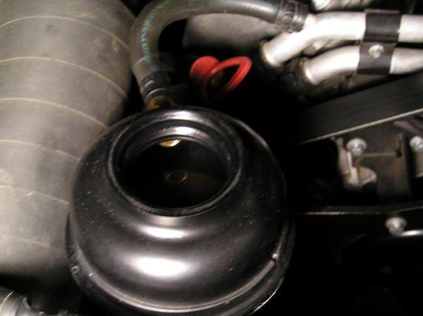

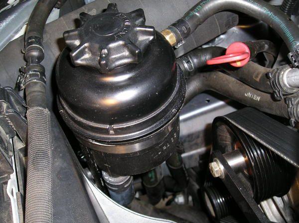

P10104621
P10104591
It's so much easier to see what's going on with the fill reservoir modification. To see if it's running, purge air, check temp., check level, and fill. BTW, you can get the pump to start running(if it's a good running pump of course)while stationary, by power braking the engine until it reaches the load/r.p.m. threshold to signal the pump to start running. And it will remain running. Additionally, the tank cap has a small vent hole, so it's always auto-venting. Never does it ever get hot enough to pressurize and blow coolant. Most of this info. I learned from "Waldig" here.

Originally Posted by dinasrt
P10104621
P10104591
I got one of those tanks (BMW?) and never put it on as I was never too sure of how it fitted in.
Yes, the BMW power steering reservoir is what I used as well. If you look closely at the second pic., you'll see a vertical piece of aluminum stock(painted black)fastened to an existing female threaded attachment point on the fan shroud. From there, it's simply fastening the tank to the vert. flat stock w/ a S.S. hose/band clamp. I can measure the flat stock dimensions that I used if that would be helpful to you. After all the plumbing is installed, it is very stable there.
I missed something on how to do the plumbing for it. Thanks for the reply.
