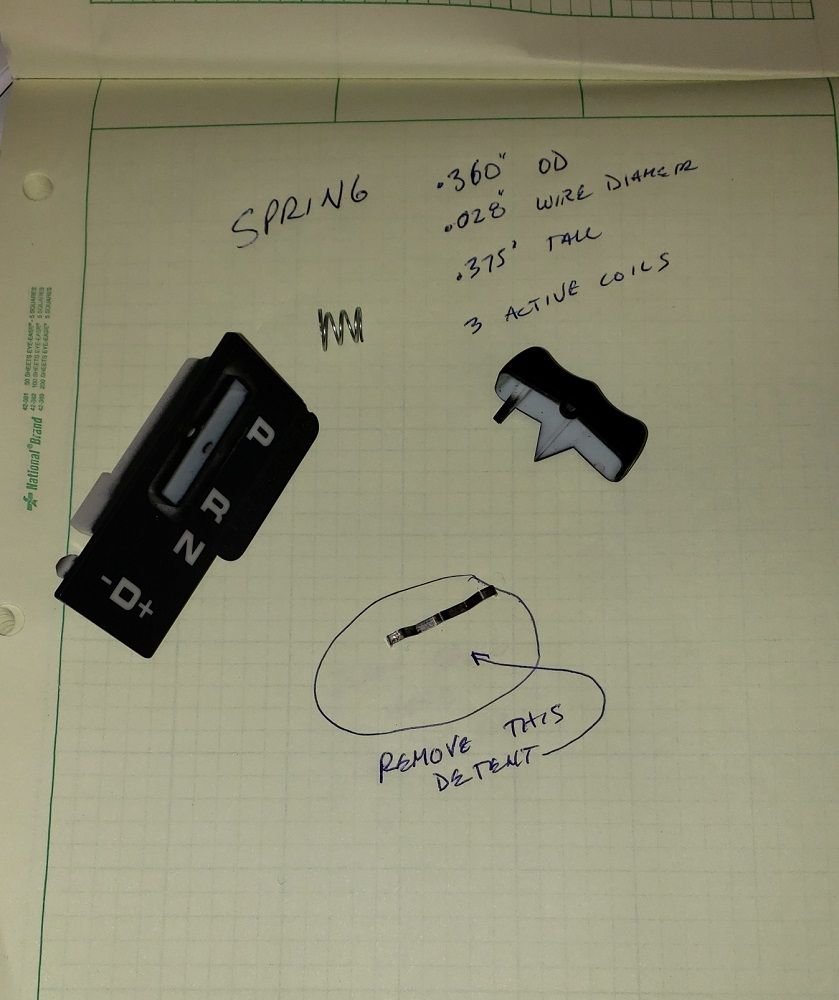

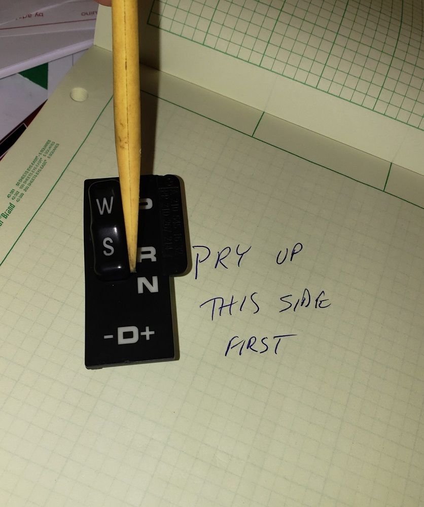

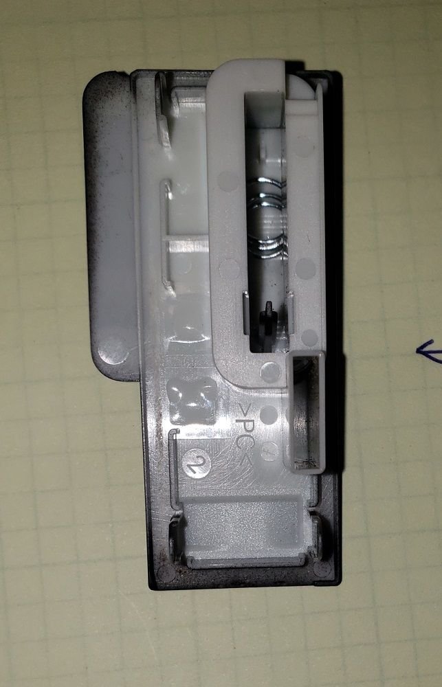

I put together some details for an update I created for the mode selection switch on R170s (and Crossfire and W210 and ?) when using a 4-Mode tune.
How to convert the "S/W" switch to "momentary" for 4-mode TCU ....
This is optional, but makes switching between modes a bit easier as you only need a single press of "W" to change modes rather than pressing "S" then "W" for each change (two actions for each mode change with original switch configuration). This Mod does NOT compliment a 2-mode TCU tune (as with a 2-mode tune, it will ALWAYS be in "SPORT"), but modification is 100% reversible.
The pictures show a "conical" spring that I made for this, but the spring specs shown (written in second pic) are for a standard (non-conical) spring that should fit and function properly.
Finally, reinstall cap with spring and confirm proper seating/orientation
