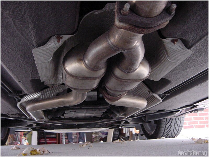

rear cats are located roughly about 2/3 or the way back of the car. before the rear axle...if you don't have them, then they have been removed previously (unless you are the first owner in which case, that's weird)

Old Nov 10, 2009 | 04:19 PM
Posts: 10,460
Likes: 159
Default Re: Rear cats delete?
I can show you the "Before" pic. I would like to see some "after" pics as well for ideas.

https://www.crossfireforum.org/forum...ght=cat+delete
this is sold but gives you a look at what to do. you see i made mine to fit into the stock pipes at the Y this way i only had one weld to do. and i can put them back if need to. jim
