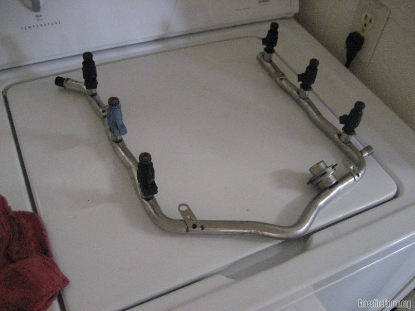

Good morning everyone! I pulled my fuel rail, removed my blue injectors and installed my purchased, cleaned, checked, flowed and rebuilt black injectors. Does anyone know if one color flows more than the other? My 2006 blues are 0280156304 or A1130780123 and the 2005 blacks are 0280156072 or A1120780349. As for me I think the blues are faster but we all know how fast blacks are too. Seriously though, I found a post on MB World saying the blues flow more but I can't find proof. If I find out the blues flow more than the blacks I'll send mine out to be serviced and put the blacks up for sale. Anyone know or have a more advanced search degree than mine?
Les
I just found the answer in a thread I posted in years ago. It looks like the 304's are going out for service.
BTW, when I went to relieve the pressure in the fuel rail nothing came out! I unscrewed the supply line and there was no pressure present. What do you think about that?

Old Jun 10, 2013 | 08:58 PM
velociabstract's Avatar
Posts: 4,525
Likes: 29
From: Puerto Rico
Default Re: Which injector is best?
I received my blue injectors from Marren. The box was opened 5 minutes ago and I'm still comparing them. 072's are blacks and 304's are blues. Blacks are 14.8 ohms and blues are 15 ohms. Static flow / blacks 410 cc at 43.5 psi and blues 460 cc at 43 psi. Check out the flow volume and don't ask why the blacks were flowed at 43.5 and the blues at 43 psi. I don't have an answer. Comments?
Les

It's good to know the flow numbers are as close as they are between the two since they are using the new with the old. The curious thing is the 410cc vs 460cc given the pulsed flow numbers and that would make sense for the upgraded part number to flow more static. Would be nice if they had flow data for 80, 85, 90 and 95 IDC in addition to static.

The volume test at 43 psi seems to favor the blacks. Static flow, which no one wants to use, the blues. I'm left wondering if one is better than the other.
I figured the blues were dirty because my car sat 2 years before being sold, to me.
Les

I know testing at 43psi is a standard but our fuel presure is set around 60psi so those aren't true numbers as they relate to our fuel system. Thus, those injectors are flowing more than what is stated in the testing phase. I wish they had a conversion table for flow based on different fuel presures.

I actually see it the other way around. The static pressure would indicate that they changed something so the higher the IDC, the less the injector choked. Neither of them should ever see higher than 85% duty cycle but when you start approaching it, I'm guessing the blue ones will perform better. I'd also guess with that in mind, that they flow better at higher pressures as well. One thing I do know is Mercedes didn't have this new injector spec'd for the heck of it and it probably has nothing to do with how it performed with the M112k but rather the M113k. which incidentally, these came out about the same time the SL55 got the 80mm TB upgrade.

Good observations Rudy. The blues are going back in. Anyone need a set of freshly serviced blacks?
