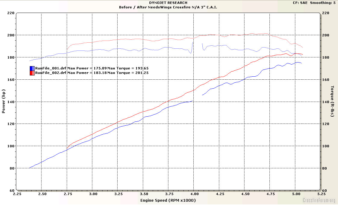

Originally Posted by Airscape
After installing the v8 box,tubes and K&Ns my ultraguage readings for the MAF increased across the entire RPM range. More air = more power, this is fact. The engine can and will take in more air in than the stock setup allows. You are making the assumption that the stock air box is able to flow more air than the engine could use and without restriction. Changing out the stock filters alone will prove that to be false as you will get more air. Step up to the NW dual on an NA and you have an argument, that setup has the capacity to supply more air than the NA can use effectively without mods.
While I admit dyno results for an NA with only a CAI and no other mods is hard to find there are still some out there. Searching needswings intake dyno in google will give you a number of results for crossfires and other mercedes v6. The supercharged versions see more HP from the mod than the NA but it is still a good amount of power/$ considering the few options we have.
Yeah, NO. The OE setup only needs to flow as much air as the engine NEEDS to be non restrictive not more. Again the air intake demand is NOT infinite ever. If the engine (any engine) does not need more air additional air is useless.
I'm talking NA not SRT, I saw that dyno result and it yielded 10hp total on an SRT.

Originally Posted by sk8erjosh09
The stock NA intake is such a HORRIBLE design I seriously can't stop laughing. Thanks ZX2 Nick. You seriously made my day hahahahahahahahah
"Seeing" and "Feeling" and "Thinking" something is a HORRIBLE design without proof or evidence is commonly referred to as bullshit. Same story here. Remember when the earth was flat?
No one's disagreeing with what you keep repeating... This is basic knowledge.
What you don't understand is that 10 horse is 10 horse... Obviously the engine could use the extra air.
Now try to understand how much more the NA intake is restricted. The screens, elbow with blockage, ribs in the box that's on the engine getting heat soaked, thin cheap small obstructed tubes that heat soak after 5 minutes of driving, running from tiny itty bitty ports in the front...
Drive your car 100 miles straight onto a dyno, and run it. Put the needswings dual on that NA (that doesn't even need that much), run it 100 miles straight onto a dyno and come back to me with "mild gains".... Don't worry I'll wait.

Seriously, didn't Rob have all of this info (dyno pulls/air bench results) in a thread here? Or was it on Needswing's website.
ZXZ, years ago I measured all of the incredible convolutions built into that plastic wonder DC calls an airbox, and, while I have no notes from that time, one of the cross sections was on the order of 2.125" average diameter (3.6 square inches area). While changing directions 90 degrees. It's a real POS.

Let me start by saying I have a NW Gen 1 3" CAI, however on the scale the Aussie boys set in their video, a 4.4% increase is not noticeable.
They 'say' it takes a 7% increase to be noticeable, I notice it because at the same time I installed the CAI, I also added a 74mm throttle body and the EC tune.
I'd like to see a dyno chart of OEM versus my 3 way combo, cause I sure as heck can feel the difference, not to mention the glorious sound of the CAI when you punch it.
My average MPG also increased from 28 to 31 ( according to my UltraGuage ), which is most likely not completely accurate as I probably have the wrong parameters set in it.
I did NOT change the gauge parameters when I did the above updates, so it's apples to apples.

NeedsWings CAI has cut the 1/4 mile times of "NA" cars by close to a 1/2 second. That's just a CAI, no other modification!
If you're not a Drag Racer, that probably doesn't sound like much.
But it really, REALLY is!
