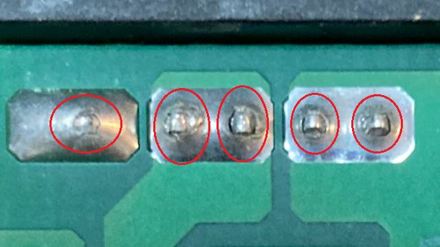

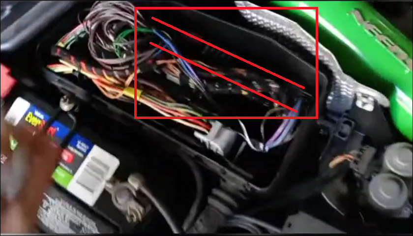

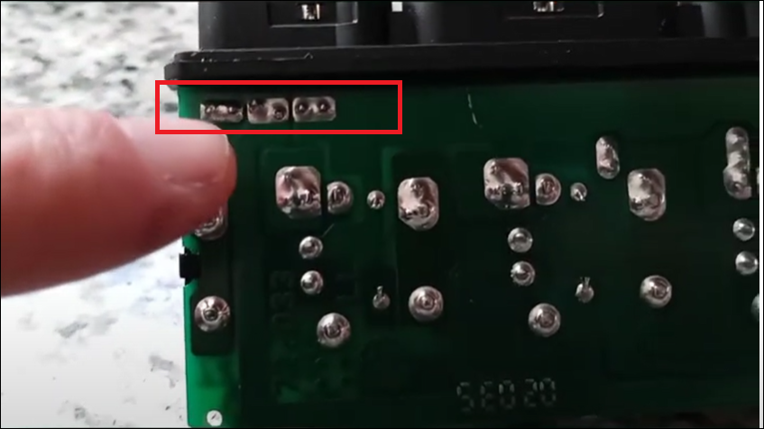

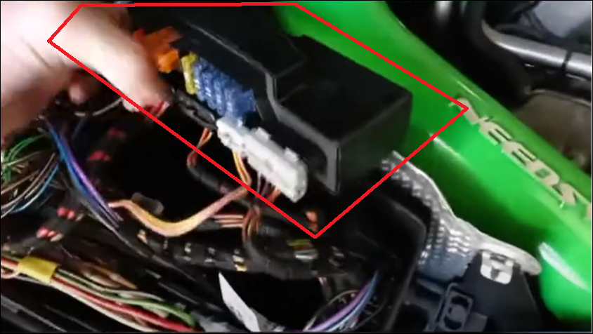

2. I removed the RCM Board as per video #1, found the bad solder joints suggested - 4th picture, (I had 4 bad on the Start relay of the board and 5 other bad solders). Repaired the solder joints.
In the 4th picture you can see the black area of NO-Contact on the solder joints, this is not typically visible on the naked eye (picture 3), take a good focus picture of these and blow it up.
3. Reinstalled and put the car back together, car started first try.
