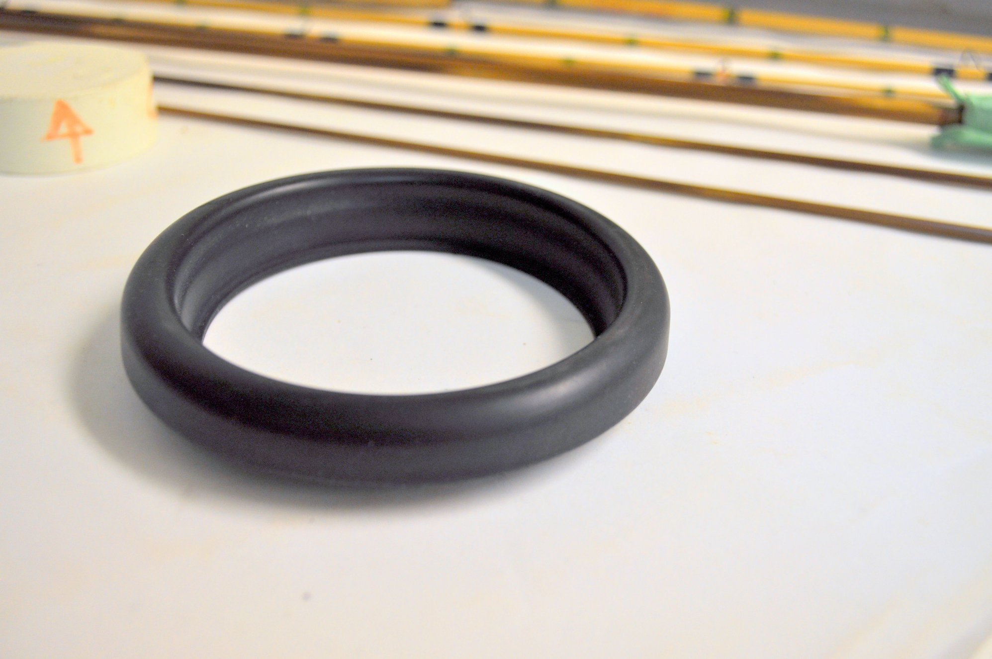

What is the seal called that is attached to the bottom of the engine cover that seals tight to the mas air flow sensor. I cannot find a place to buy this seal. Mine has some dry rot which may be causing a slight air leak. Anyone know where to buy this? I checked ebay but could not find a match. Thanks. Also I have the crank shaft position sensor on order. I will update after I replaced that.

Originally Posted by jamesmonter2
Guys,
Is this what you are looking for?

Yes that's the seal I need to replace
Here are the details of the part.
CLICK
Part number 112 094 01 80
