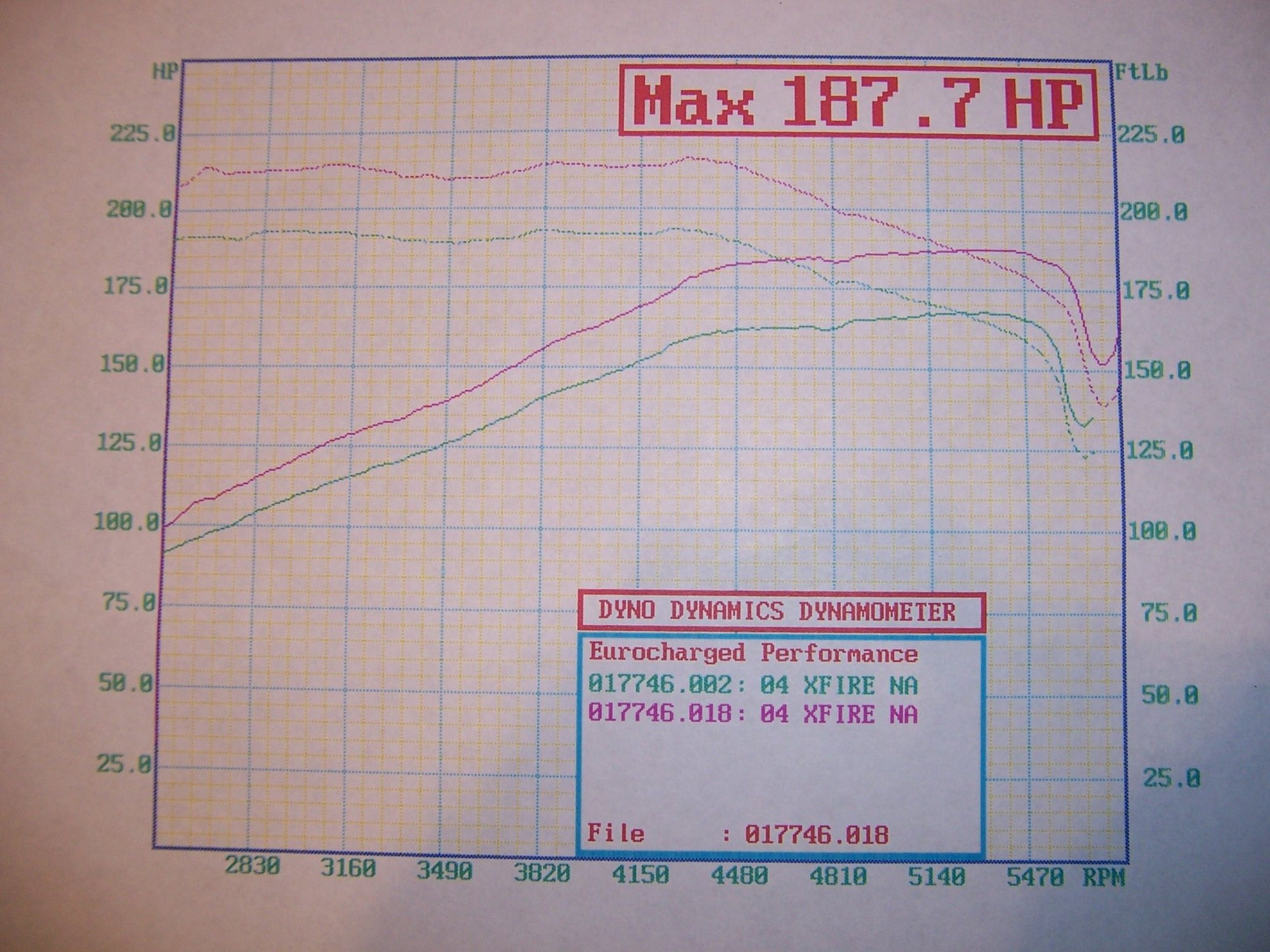

Is Eurocharge the only reputable tuner there is? Also, what kind of horsepower and torque gains can be expected fro a N/A roadster?

To my knowledge, no one has ever posted any VALID results from a dyno run from before and after the 3 mods.
Lots of "butt feel" info however, my butt says maybe 30 HP.

Valk posted two dyno results, one before and one after a tune.
I have them somewhere or they can be found on this forum.
The max horsepower of a tuned NA is about 195, someone claimed over 200 but never put up the dyno sheet so we can discount that one.
I am assuming that is rear wheel HP ?

I am assuming that is rear-wheel HP ?
I was referring to the dyno results mentioned in my first sentence, so yes it is rear-wheel hp.
I see the NeedsWings SCAI as a bit is a waste of money on the NA. A larger two-piece Mercedes engine cover cannot be much different in airflow and it can be had for about $100 in excellent condition. I got a new one on eBay and it came with brand new filters, it had a few storage marks on it that you had to look for and the front part was in excellent shape as well. You have to be careful that you get the correct one though, others look the same but foul the hood liner. I took two to the dump until I found the correct one.
Valks dyno tune results in St Louis I believe. There is another chart from an NA that has more mods and the max hp was around 195 hp.
Here is a PDF on NA mods using a Mercedes engine cover.
After tune.
Before tune.
I think that the tune was all that was done to the car. Maybe Valk can tell what was done to the car.
