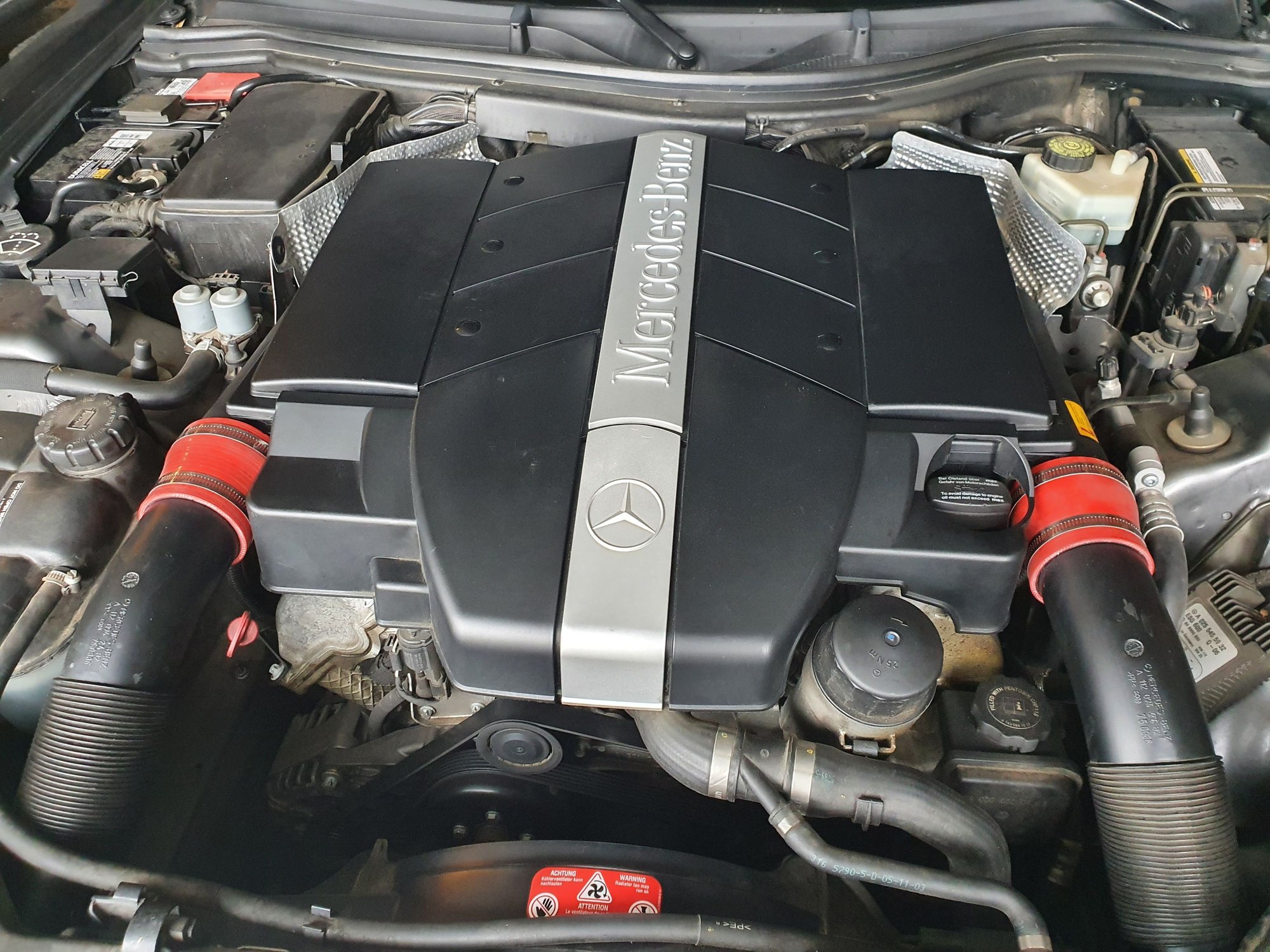

So, I swapped out the air box this afternoon.
The only cutting necessary was to take an inch off the intake tubes where they meet the air box. I think it came out pretty good.
I used red adapters because, you know... red makes everything faster. 🤣
I used the stock intake tubes (for now) until I decide whether or not to do the NeedsWings CAI somewhere down the line.
I just got my Sprint Booster delivered yesterday. So, that's next on my "to do" list.

Originally Posted by Buck62
that is quite a bit of oil leaking down your valve cover, time to reseal the upper panels before enough of it drips onto your hot exhaust manifold.
