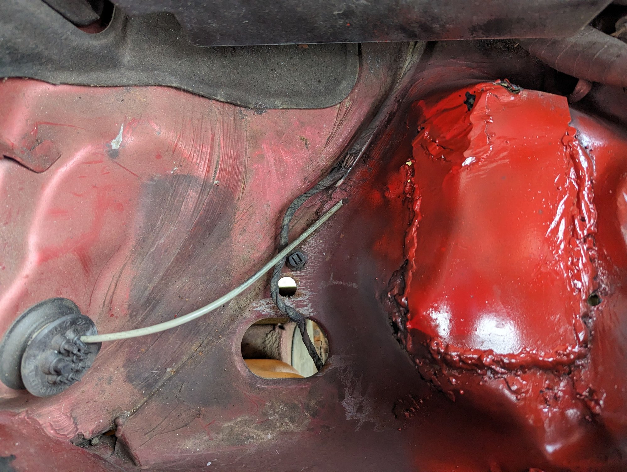

I got my hole repaired. I had a helluva a time with the welder and small space. It's not a great job but it's covered. One mistake a I made was not putting down a heat shield over the air hose and electrical wire. I check popped off from welding and it melted. Anybody know what I can use for repair. I was thinking a hose to match the outside diameter and sleeve the break.
The top side of the hole
from the wheel well

If the distance from end to end is not too far, auto parts stores will have an assortment of vacuum fittings. You just need the right size coupling.
I find myself thinking welding first for many a repair, but with the new adhesives they are often the best way to go. If applied properly the SEM adhesives are stronger than welds.

A mouse chewed my gray pneumatic line. I used a slightly bigger tube and shrink tubing to fix it. I put the larger tube over the gray tube, and then shrunk the shrink sleeve over it to make is stay and be more airtight.

I repaired the damage from my welding on the vacuum line and electrical line under the battery box.
Damage
Here is the fix.
Fixed
I read in another post the vacuum line goes to reservoir for the heat/AC system. I have no idea what is the electrical circuit. Anybody have any idea what is this?
