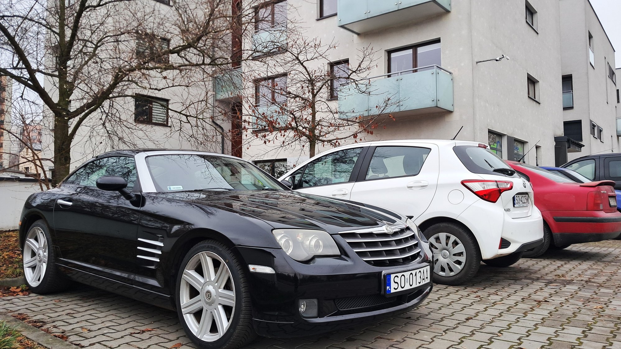

Hello,
A few days ago I bought a Chrysler Crossfire Coupe 218HP with an automatic transmission manufactured in 2004.
Driving this car gives me incredible joy.
But I would like to get advice on one thing. Namely, not every time, but usually when switching the position of the shifter on the automatic transmission, you can hear a grinding sound.
This also happens when starting the car, i.e. when I slowly release the brake pedal, sometimes you can also hear a grinding sound.
Please help.
