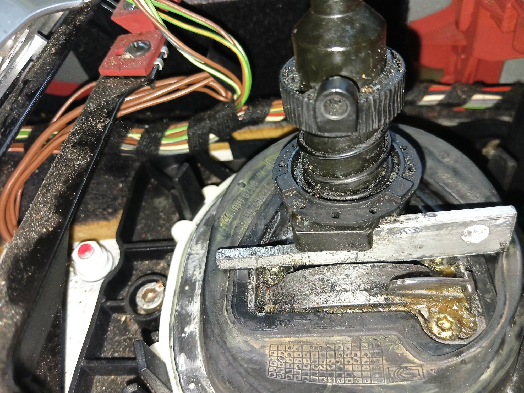

Background on newly acquired car. 1st to 2nd was very sloppy and had to hunt for it and hoping it didn't go into 4th. So this morning I put her up on ramps and the "reverse cable orange button was out and not pushed in" which is normal. I used my Miller Special Tool 9120 on the shifter, crawled under and pushed the orange button "IN" unlocking the cable. Screwed up and did not follow instructions and should have released the button back out Got back in the car and 1st to 2nd shifting and "seemed" all good. Was wanting to take it for a spin, put it in reverse and "NOW it wants to go FORWARD!" Corrected myself and pushed release button. IS THERE SOMETHING I'M MISSING ON PROPER ADJUSTMENT OF THE REVERSE CABLE????

I'm just about ready to throw in the towel on this one. Re-read PDF manual and followed instructions three more times. I even tried adjusted the reverse cable without using the Miller Tool. The orange button is supposed released "out" which locks it in place. It's really hard for me to believe the syncros in the tranny are keeping it from shifting properly. Never hear any grinding. My really good deal buy isn't going to be such a good deal if I have to buy another used tranny. Rebuilding is cost prohibitive for tranny synchronizers. I bought another shifter assembly thinking it might be that. That was $429 and am returning it for a refund.

SUCCESS! YEA! After much contemplation about the reverse cable adjustment I figured it out. 2nd gear and all the others are fine now. Fourth time adjusting worked like a charm. Jacked up car, crawled under, pushed in the orange lock button, crawled back out, inserted Miller 9120 tool, jiggled the shifter around, crawled but under and released the cable lock. By jiggling the shifter it was moving the cable lock in the proper position before locking in the cable lock.
