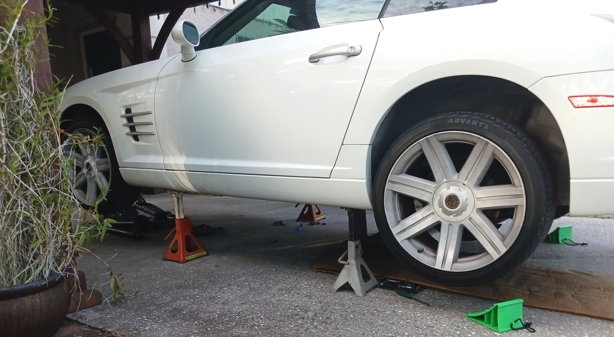

Little chilly this morning so I'll wait another hour to start reassembly. i posted a pic of the car up on jack stands. I really dislike the finish condition of the rims. When time allows I'll paint them the same color of the rims on my 2006. I painted the center caps on the 2006 and added Mercedes logos in the center. I think it looks pretty good.
