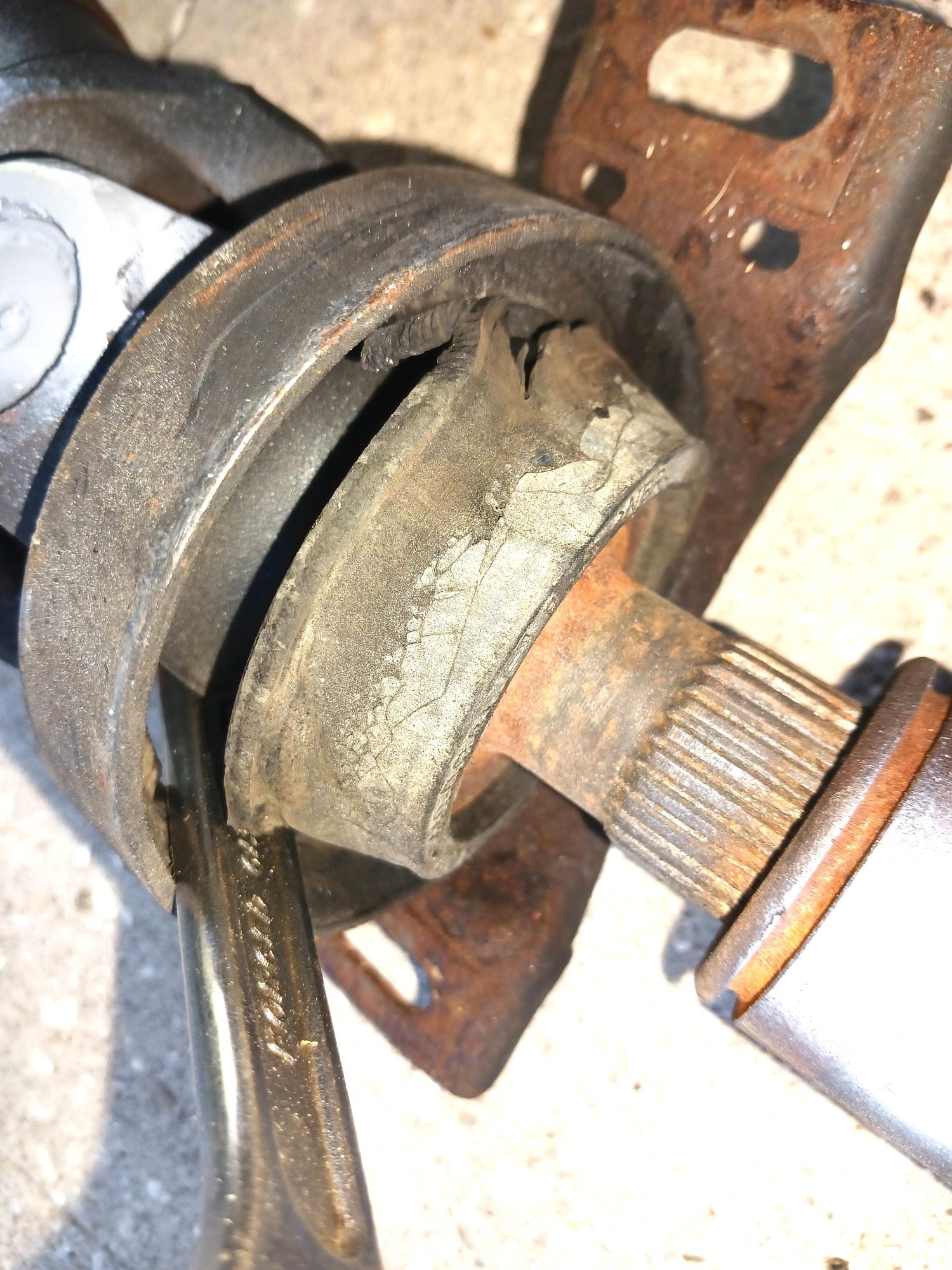

Putting new drive shaft support bearings in today. I did not realize there are two support bearings and both are shot! "ONLY TOOK ME 2.5 HOURS, LAYING ON MY BACK, TO REMOVE THE SIX BOLTS ON EACH END!" Can someone explain how to drop the drive shaft and pull it out the back end? I used a screwdriver to separate shaft from "Rubber Guedos" but there is no room to back off to allow the drive shave to be lowered! There has to be a trick to this. Any help would be appreciated so I can get my car out of the driveway! In the mean time I'm gonna take a coffee break!

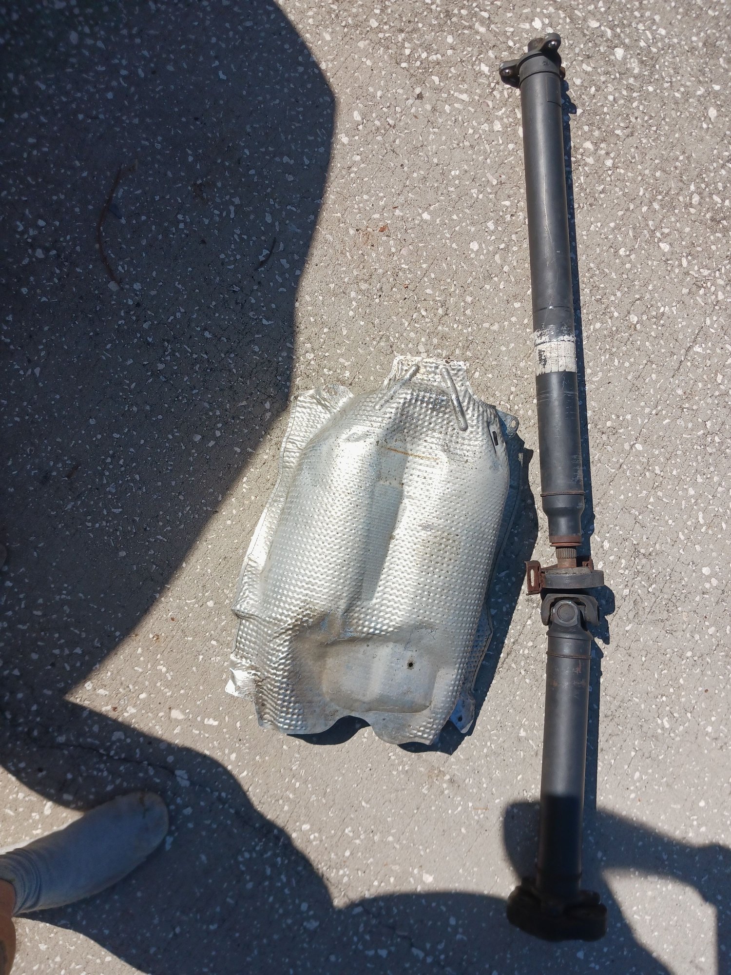

"SUCKCESS" ON TYHE DRIVE SHAFT REMOVAL. AND IT "ONLY" TOOK ANOTHER THREE HOURS OF FLOUNDERING AROUND UNDER THE CAR AND USING SPECIAL WORDS! Figured out the driveshaft just wasn't going to come out without lowering the last section of the exhaust system. My heat shield just kept getting in the way. To remove the shield the exhaust has to be dropped down which allowed the shaft to just fall right into my hands. Don't think I can get the bearing on and installed today but things are looking up right now. The splines are not coming apart so I'll go and look into that shortly and figure out bearing removal. I supported the front and rear sections of the exhaust.

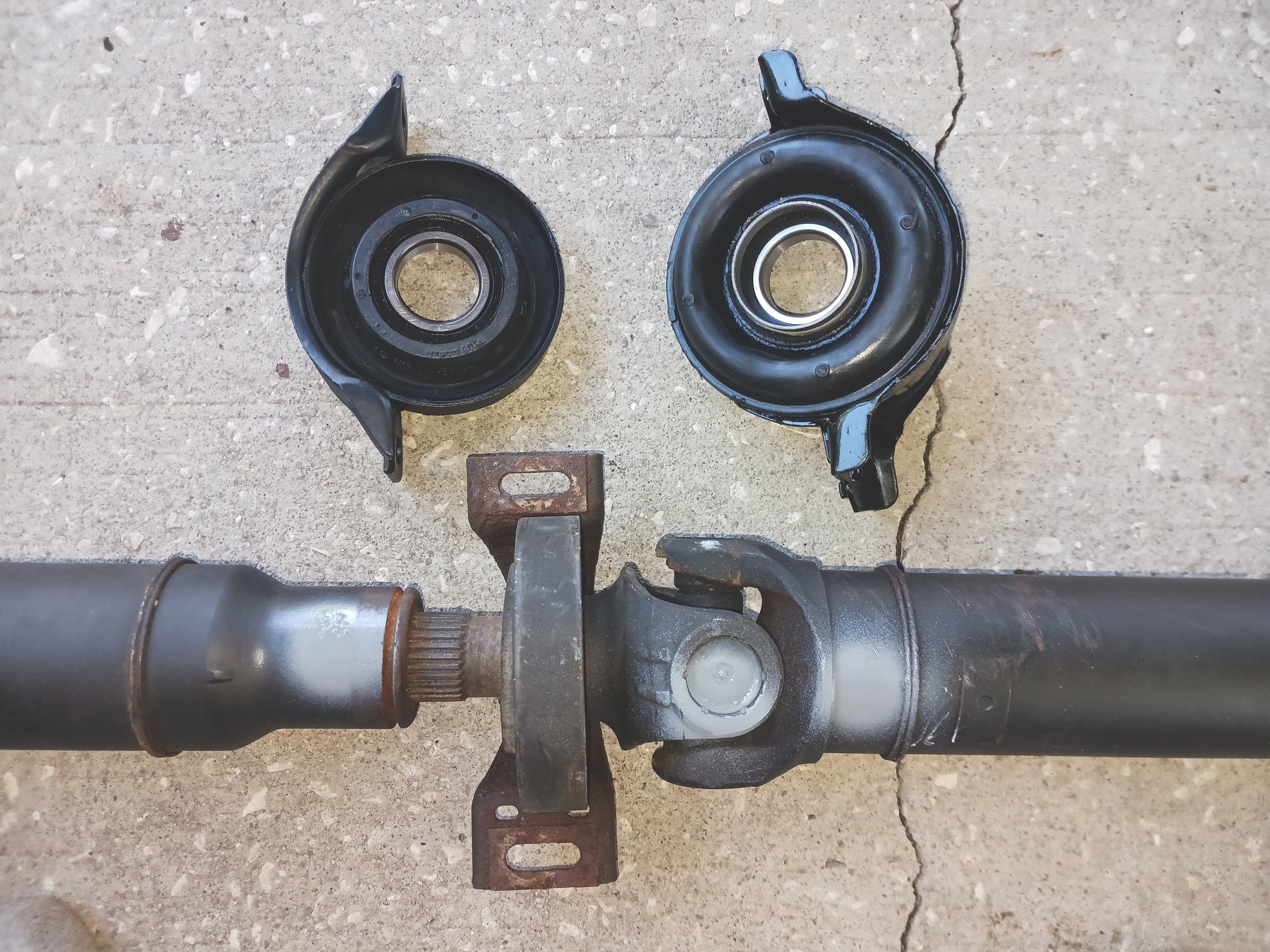

I have two styles of support bearings. The one on the left is like the original that's installed now. The one on the right is more than likely for use with an automatic transmission. I'll go with the original style.

I don't think the support bearing shown on the right is the correct bearing for a Crossfire. It looks like it's for a different class of Mercedes-Benz.

The bearing on the right is what's being sold for all Crossfires but stipulates for A/T tranny's. The one on the left is the "only one" I found that stipulates for std transmissions for $23. It is the correct bearing for std shift transmissions even though the other "might" work as well but is much more robust and stiffer in construction.

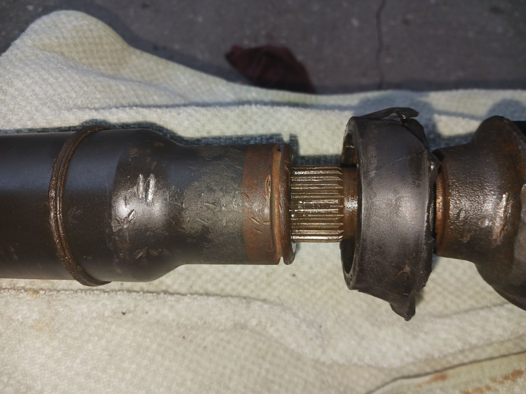

After soaking in WD-40 for the last 24 hours and beating on the meaty part of the u-joint, it hasn't budged. Guess I'll have to try heating with the torch on the splines that are sticking out. I'll wrap a wet towel on the u-joint to protect it. Any suggestions would be appreciated!
If I wind up having to remove the u-joint I'll replace it with new one.

UPDATE THIS AFTERNOON: I don't think the WD-40 is seeping down the splines. I think it's just puddling around the splines and evaporating! When I tap around the collar it doesn't seep down. Maybe I could try 50% mix acetone and AT Fluid. I had good luck with removing WWII rifle barrels off their receivers but took awhile. Don't know that I have that much time.
