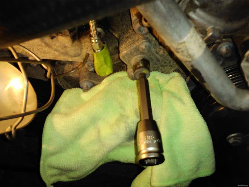

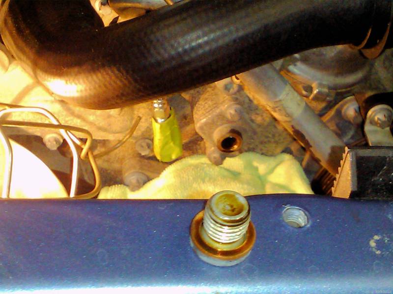

Pressure Port
Removing plug
Open port and plug

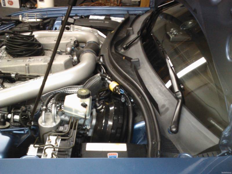

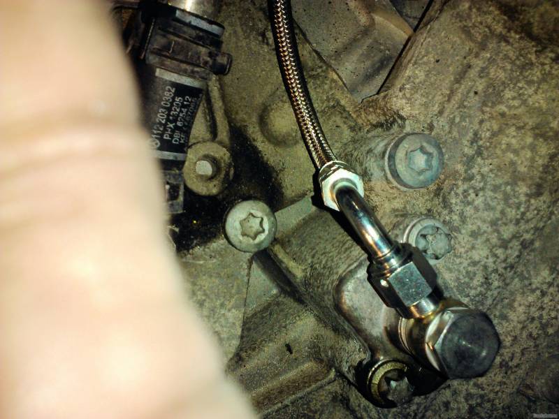

Banjo and 90 -3AN ,stainless Teflon Line installed

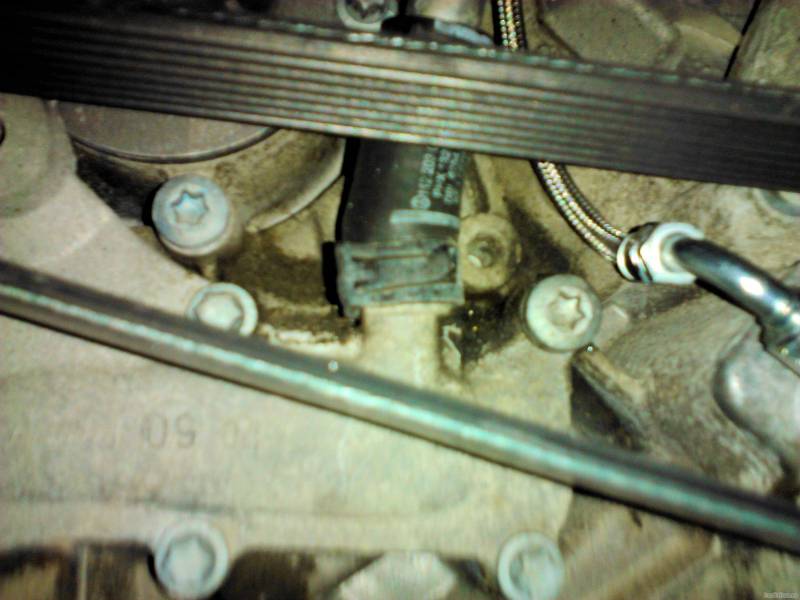

Plenty of clearance from belt

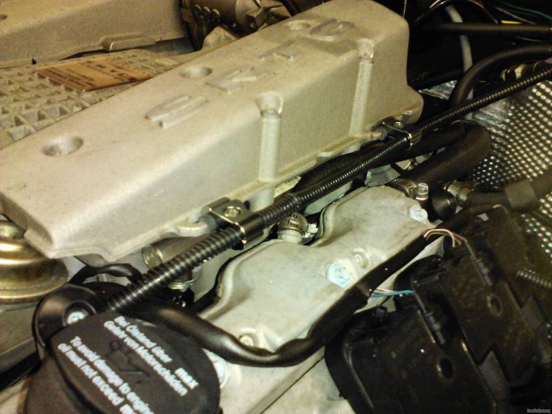

line covered and mounted to Mani using Billet Wire Seperators

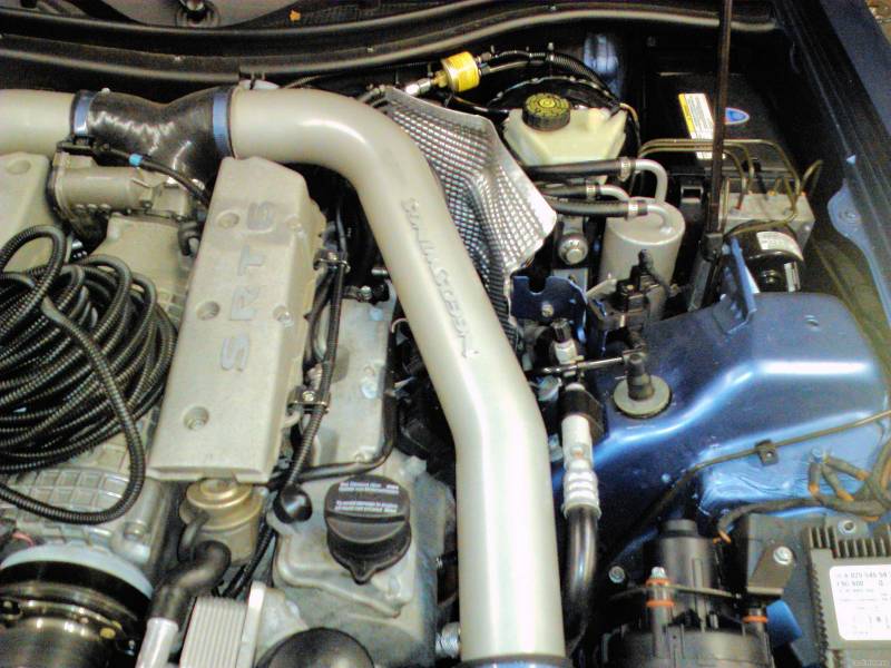

Finished install
NO Leaks ,gauge working great first started the car OP @ 80 psi for 30 seconds then gradually dropped to 45 and stayed there . HAPPY CAMPER

When I saw you were using SSbraided line, I thought you were going with a mechanical gauge. I assume there isn't enough room to install the sender on the engine?

James . I couldn't really find a suitable spot on the engine , I had thought about the location of the rubber bushing (for lack of a better word) that help hold the stock enjine cover down , but decied to run it back to the firewall. this was a fairly easy and clean install and is well out of the way of the belt if the belt where to break or come off it would not effect the fitting . pull the fan and belt and your there.
