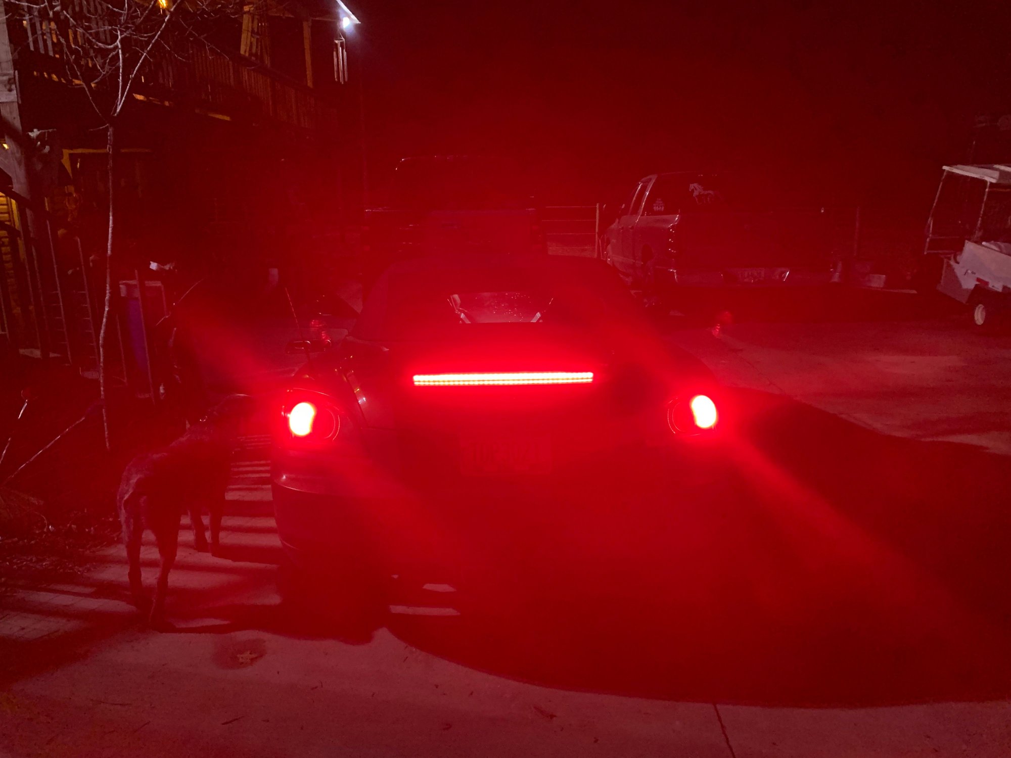

Just an update in case anyone cared, put two new brake lights in and i guess it fixed the 3rd brake light in the process. Glad I dont have to worry about that now. Thanks everyone for the replies
