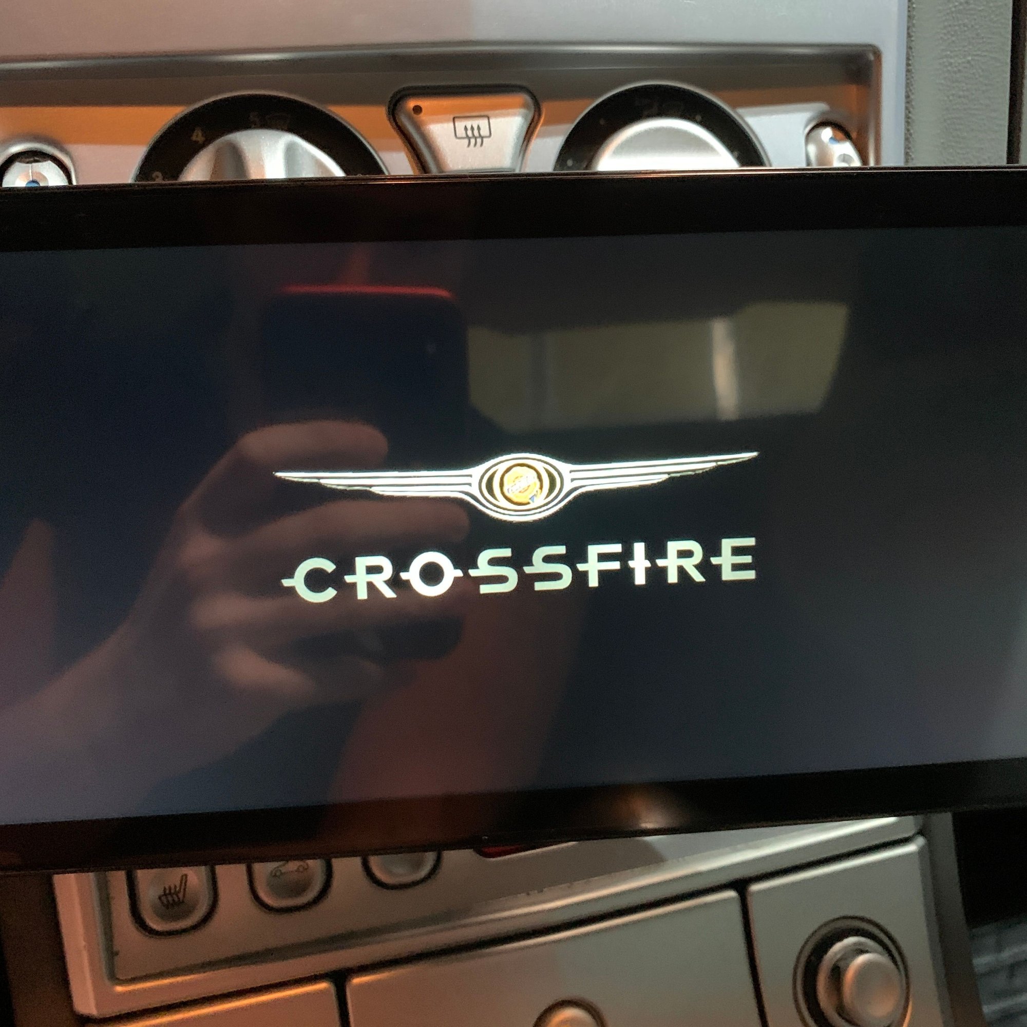

I have made a simple boot logo for my car's new stereo. I figured it might be needed for other cars.
Resize it to match your car stereo's display resolution for best results. For mine, it is 1600x720.

I did some tweaks and landed on this design.
Instructions for use:
Get USB drive (I used 64GB)
Format the drive (I used NTFS on mine, do FAT32 if you have issues)
Plug in the drive to the stereo USB
Turn on Stereo
Open Settings
Go to the "Factory" tab
Put in password (mine was 8888)
Scroll down to export factory settings and export
Plug USB into computer, make backup of the settings
Change out the logo.BMP file to the one provided.
Plug USB back into stereo
Click the Import factory settings
Wait for reboot
Keep in mind that these steps may differ between stereos. Some may allow you just to plug in the USB image file and call it a day. Mine did not.
Since the forum does not allow BMP image files I have made a google drive link. (https://drive.google.com/drive/folde...FP?usp=sharing)
Attached you will find the final result on my stereo.

Stupid question.
I have never seen the logo with a red circle with the blue line through it.
Guessing symbol for the stereo you bought?
Or something totally different?
Thanks
Jim
Old Dec 17, 2024 | 01:12 PM
Preston's Avatar
Joined: Sep 2024
Posts: 8
Default Re: Chysler Crossfire Aftermarket Stereo Boot Logo
Honestly, it was one of the only good clones of the logo I found online.( https://www.tuninginstyle.com/cdn/sh...g?v=1678183233)
It looks like they may be trying to hide the Chrysler logo for some reason.
The next best I found is this. (https://mufflerexpress.com/cdn/shop/...g?v=1613704295)
I wasn't a fan of the Chrysler part of and wanted it to just say Crossfire.
I may be able to combine these to together for the best of both worlds... One moment.

I decided to go with the V2-1 (No R) version after looking at in real life.
See the attached photo
