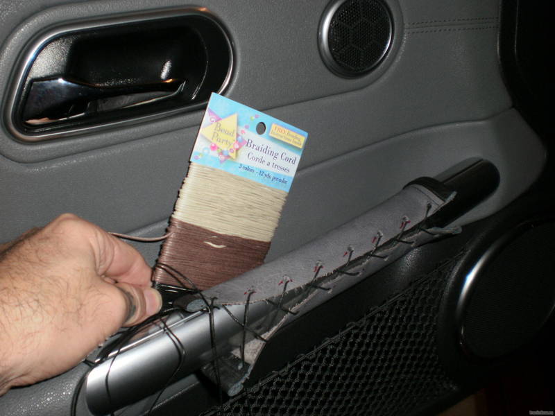

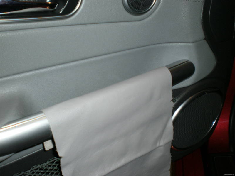

Ive cut an 8"x4.5" piece of gray leather, 4.5 wraps around the pull and 8" wont drown out the steel of the pull (balanced look). Then Ive cut black leather strips that will fold over the ends and cover aprox 1/2...they will be sewn on. Im going to use a hole punch to make eyelets and find something to simply lace them up on the inside/towards the door panel where its not visible. Im not to concerned about having to remove them if I need to split open the door pull. If they come out ok then cool, if not thats ok too cause Ive managed to keep busy one more rainy cold October day

almost done. the wife sewed the black trim on and I hammered it flat. Marked off about 1" and used a hole punch thing she had in her sewing kit. Darked the leather with shoe polish. Now to just lace them up

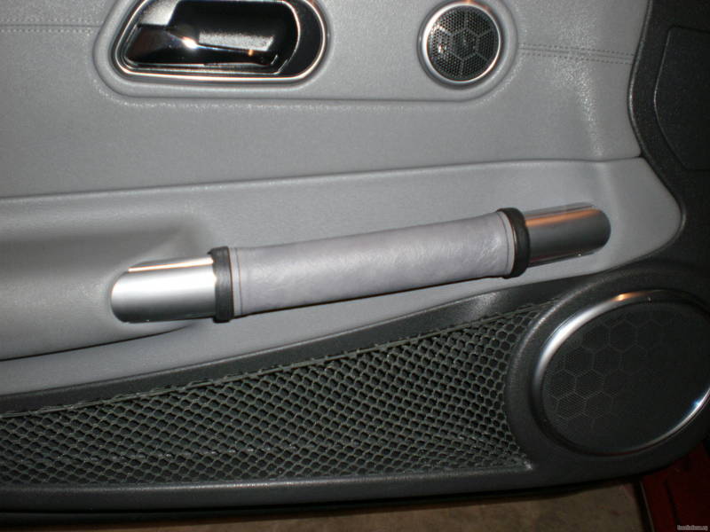

laced them up with about 1 yard of bead thread (walmart). Laced them as in the pic, tightened it up and tied it off. then grip it and twist it around so the thread doesnt show. total cost was about $5. What do ya think?

Not too shabby! Looks nice, and matches well.
I think I would have made it a tad longer. That's just me, though! Maybe slanted the ends a bit?

I would prefer if it covered the whole tube handle. You can always scrunch it a bit to have access to any type of screws or clips.

Great job, I also agree that they should be longer, and slant in with the form of the complete handle, and would be a lot better in the colder weather to grab, or hold on to while your driving, and at worst case you just remove the stiching to gain access to the screw, again great job and idea.
