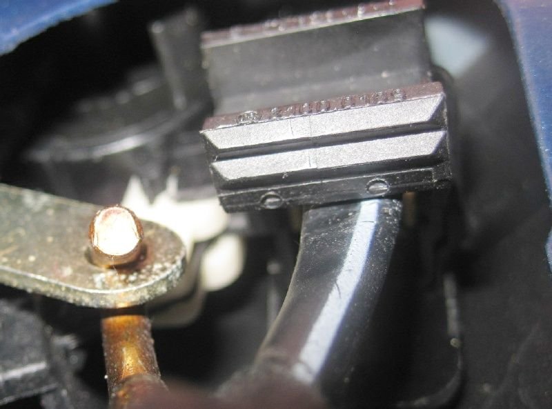

Starting a new thread since just have one thing left to remove: inside the driver's door and next to the calble release for the lock at the rear of the door there is a wiring harness connector. All of the manuals just say "disconnect the harness" without a clue on HOW.
It seems odd as the wire bundle seems to run over and down. There is a catch but releasing does little since I do not know which way to pull. Surely someone here has disconnected this harness. (see pictures).
From top
Looking back

OK you slide a finger way under the connector, lift and wiggle gently, and the whole thingie slides out.
