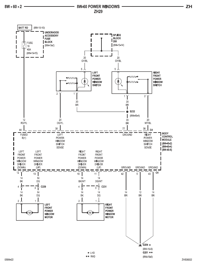

Hey there Crossfire folks! Our passenger window has been acting up and not going up every time, so we took it to a dealer. They said it's a module that needs to be changed...parts/labor $2500. Anybody had a similar issue and does this cost sound about right? Thanks!!

Could be the body control module, I guess :

thank you! i read a similar thread and the BCM was the issue. on that thread, they said their cost was only $1000. wow what a big difference! we're picking up the car from the dealer and will see if we can get it fixed elsewhere.

I would be curious how they diagnosed that the switch isn't bad...

Is it a coupe or a roadster? I would take off the door liner and see the window mechanism work. Maybe you can see the reason.

Like hell it's the BCM. This is TYPICAL dealer troubleshooting, 'Oh, there is an expensive module and since I know nothing about electronics, I'm sure that's the problem. It can't be a motor or a switch or a corroded connection."
As for the cost, keep in mind a new lock cylinder for the ignition is around $200, and it takes no more than 2 hours to change - but every time someone gets one replaced, it runs $850-1200. Dealers are the LAST place you take ANY car.

Pizza is there a specific body control module on this car or is it several modules by different names? Thanks trying to help out a Facebook member
