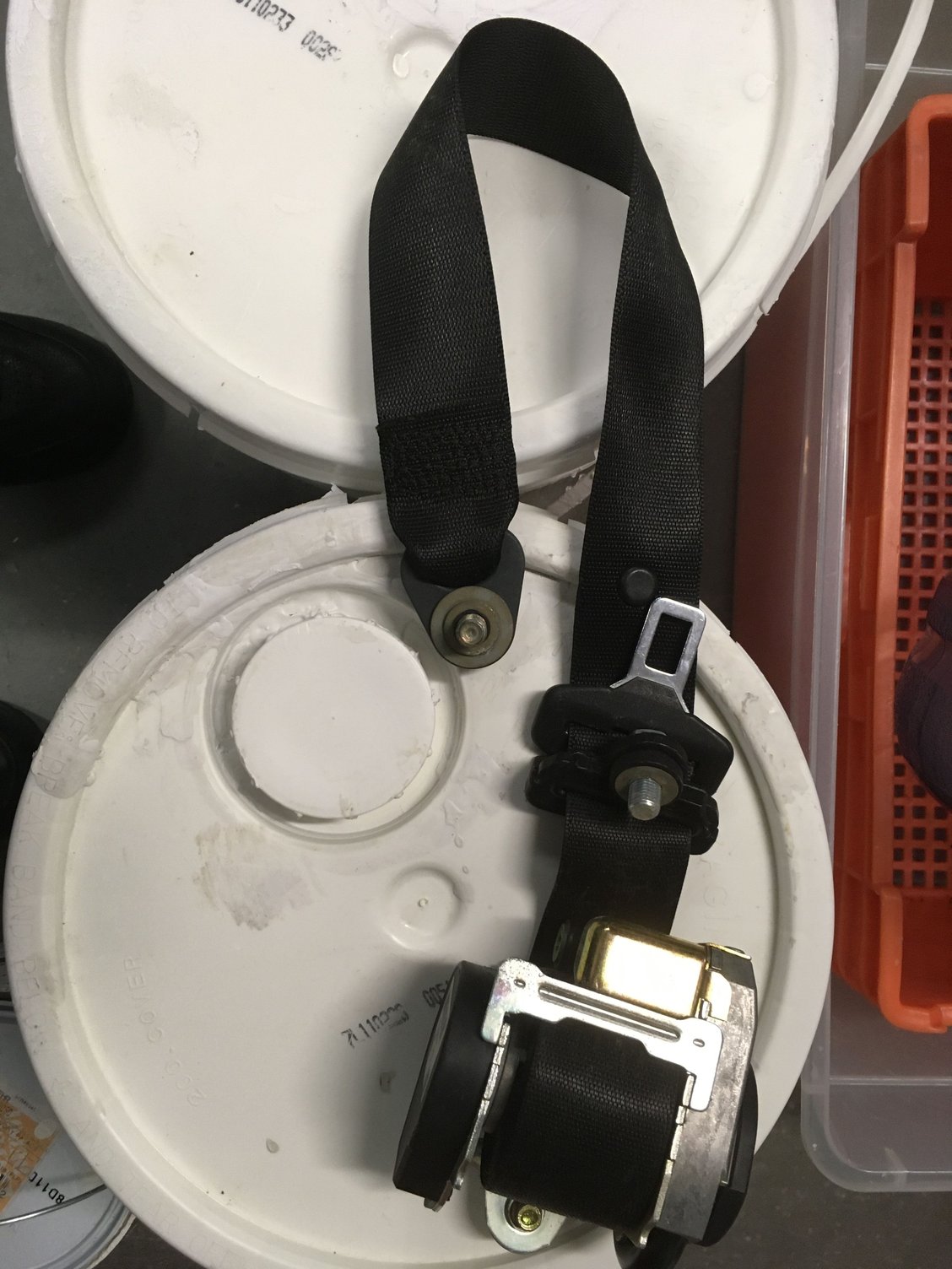

I am swaping my drivers seat ,,,take a pic and i may have what u r looking for. jim

the complete belt
the latch
the center plug looks like two wires,,,pne blue one white

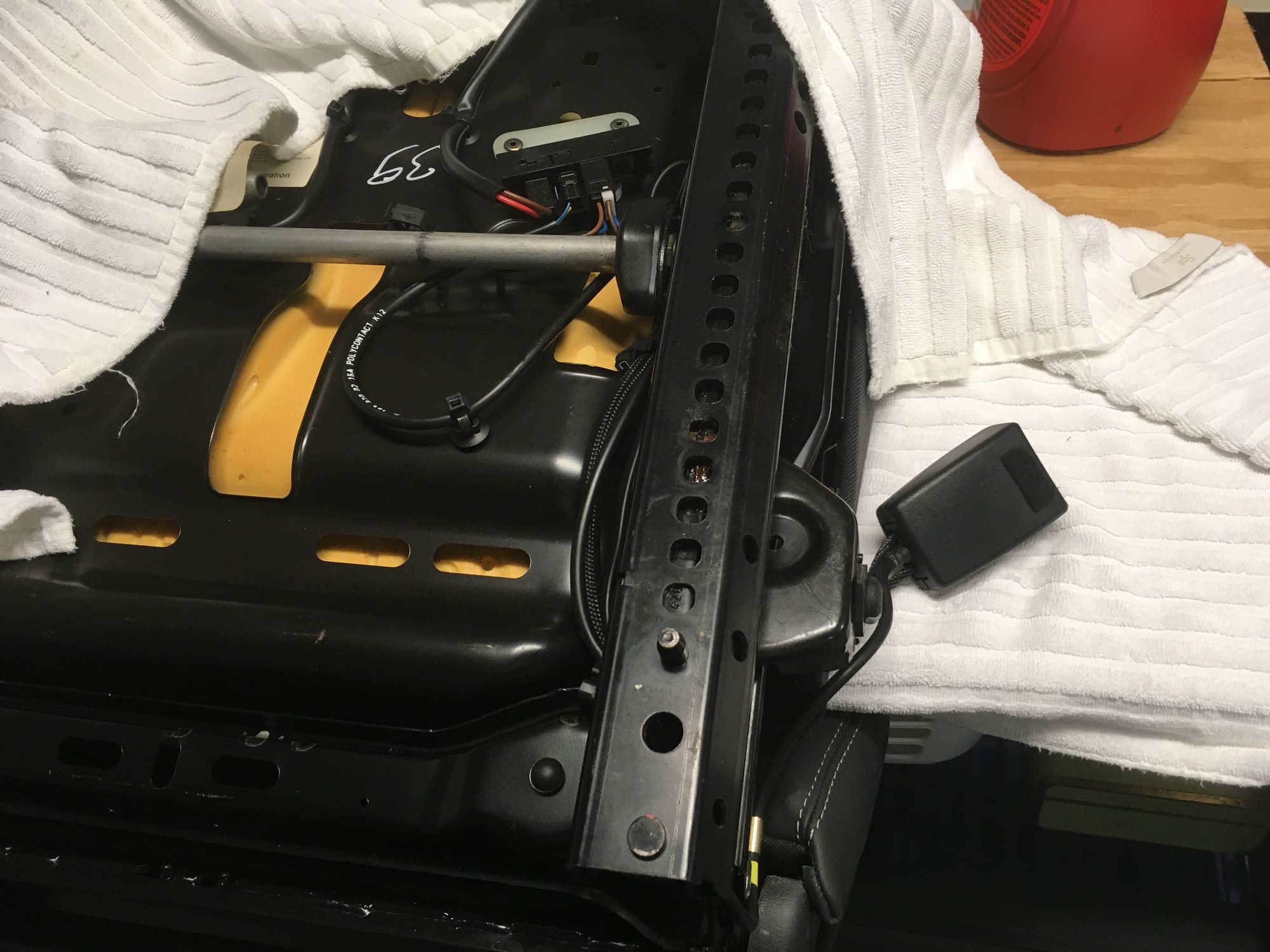

the seat.

the complete belt
the latch
the seat.
that part with the red button is what I need to know if it's one or two cables... I'm assuming that it is a two connector for that red button latch, thank you for looking and sending images! Thanks
Edit: after looking it looks as if it is one connector with two wires coming from seat latch mechanism..

yes,,,one connector the wires are one blue and one yellow,, the pic with the connectors it is the one in the middle.

Took apart seat and seatbelt mechanism was fairly easy to replace. Two plugs for drivers seat that are connected to a box under the seat. No need to remove whole assembly under the seat. Simply push two small tabs on the sides of the connector box and the cover comes off and you can remove cable ends and seat latch. Done. Now my seatbelt is functional again and now to disable the warning light and buzzer obviously without cutting any wires!
