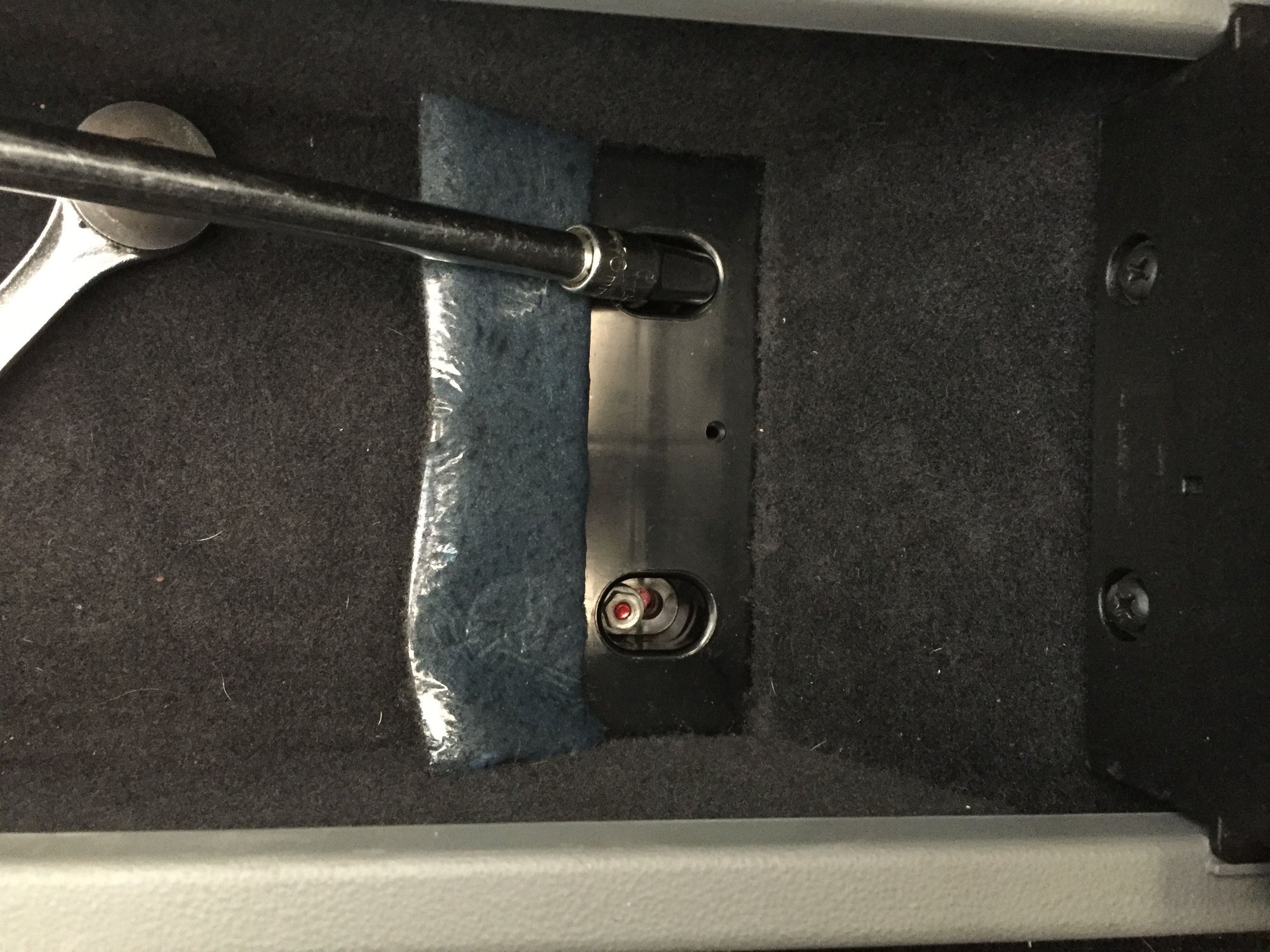

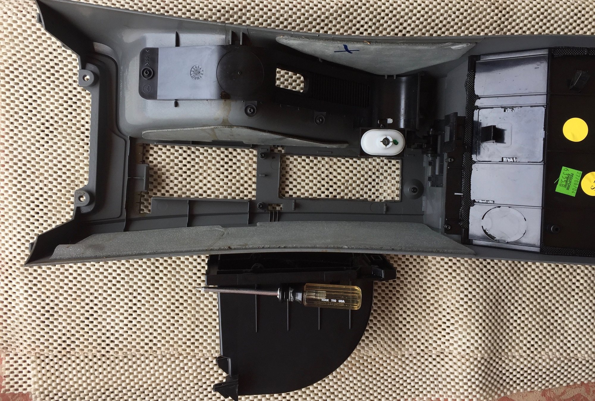

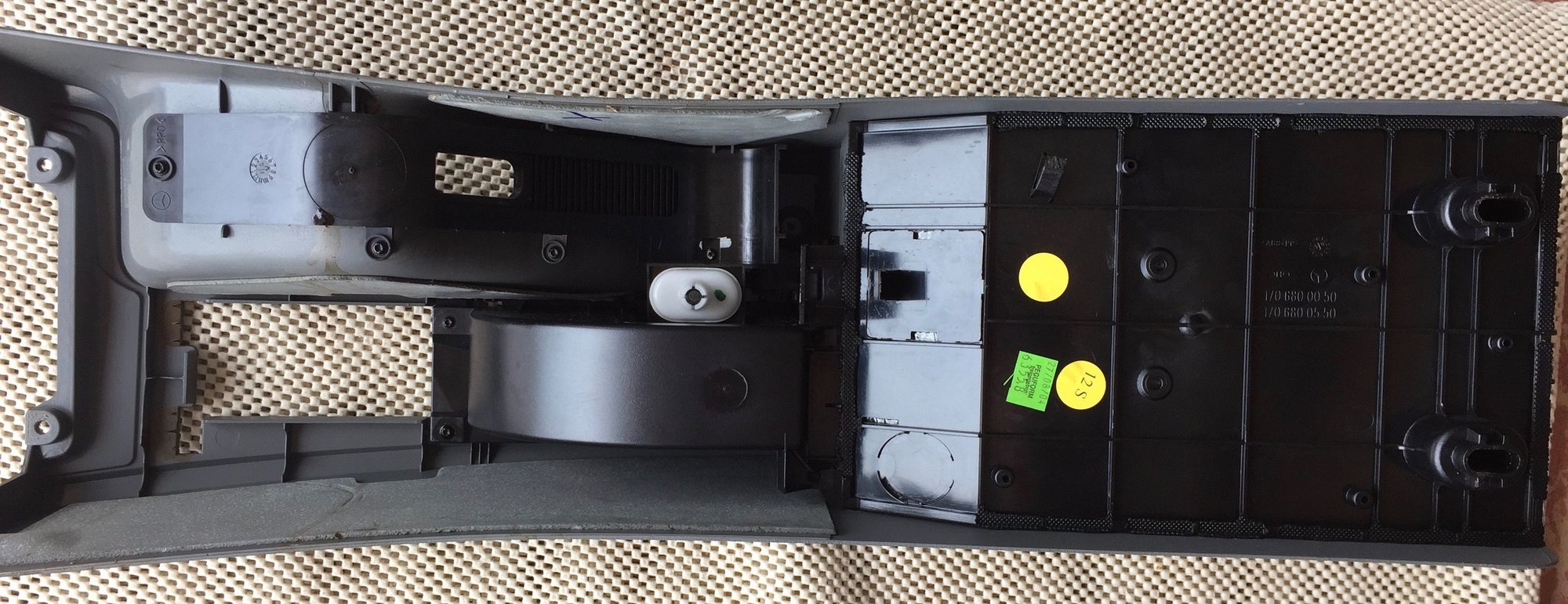

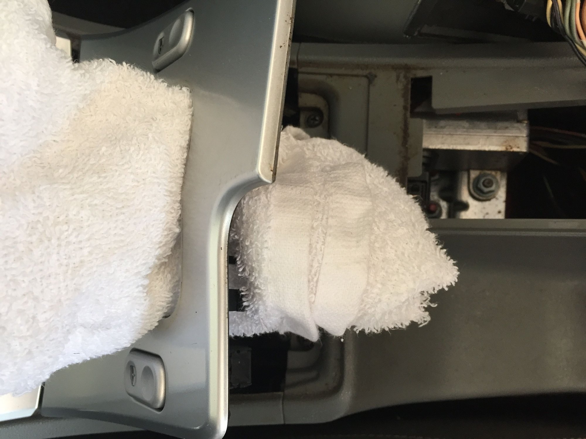

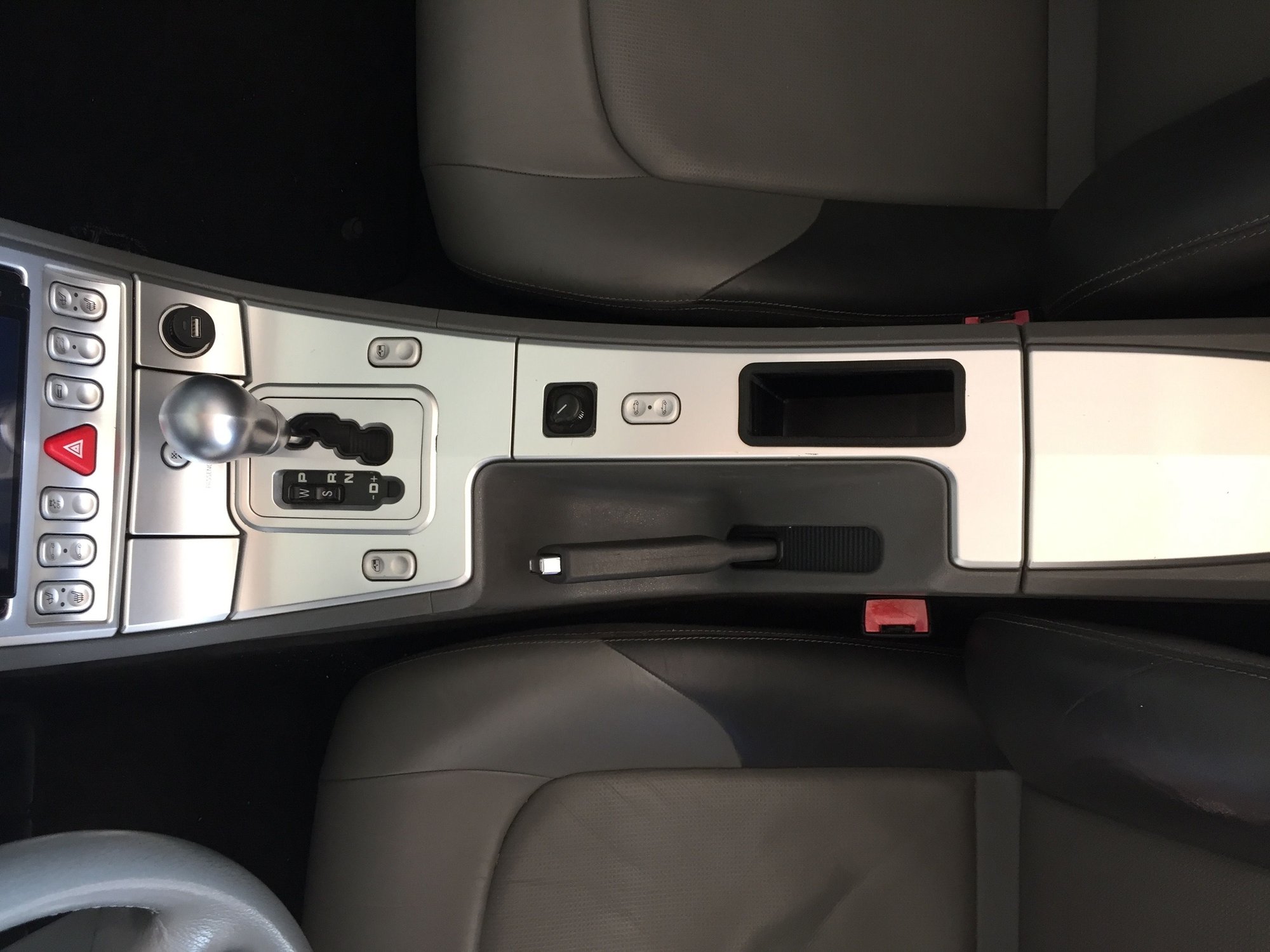

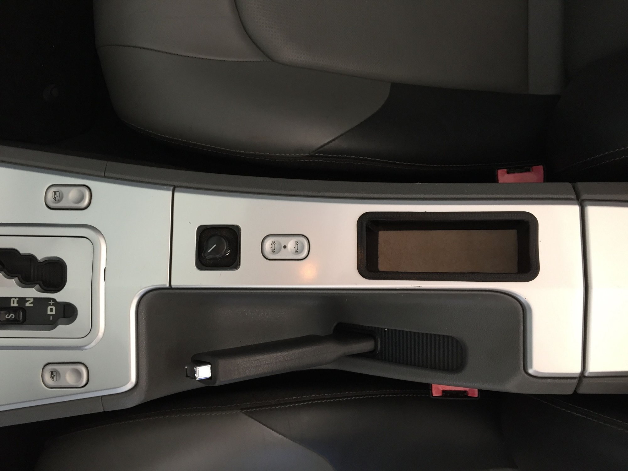

Default New Bin

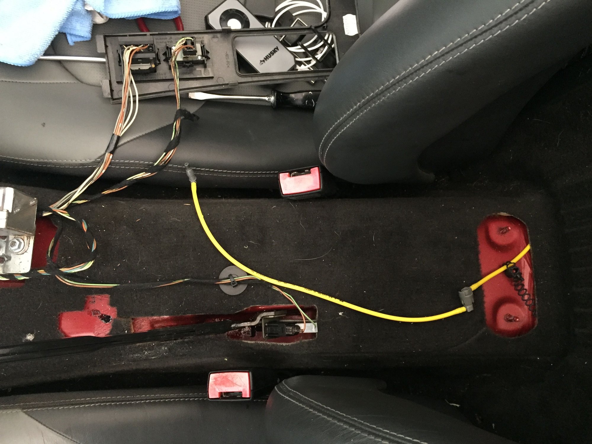

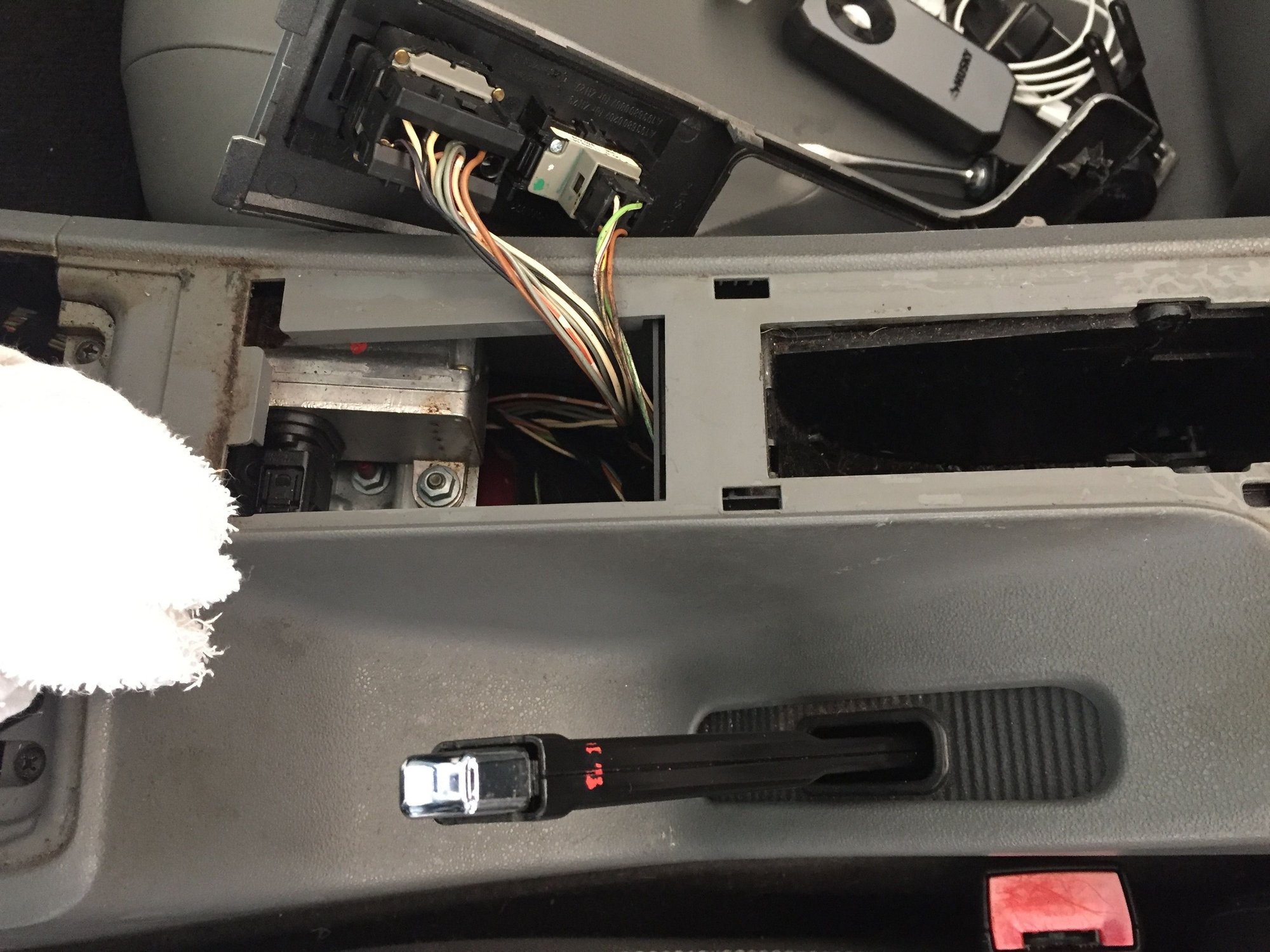

!0 mm socket
Lots of dirt under plastic
WD 40 to remove brake handle cover
(4) # 10 torx screws to remove the bin
Bin removed screws reinstalled
Clean, clean, clean! WD40 worked great on gunk
Snapped back nicely with a second pair of hands
Dropped in a piece of thick felt padding. Done!
Received the new bin this week to replace broken cup holder. Easy install, lots of clean up under plastic.
