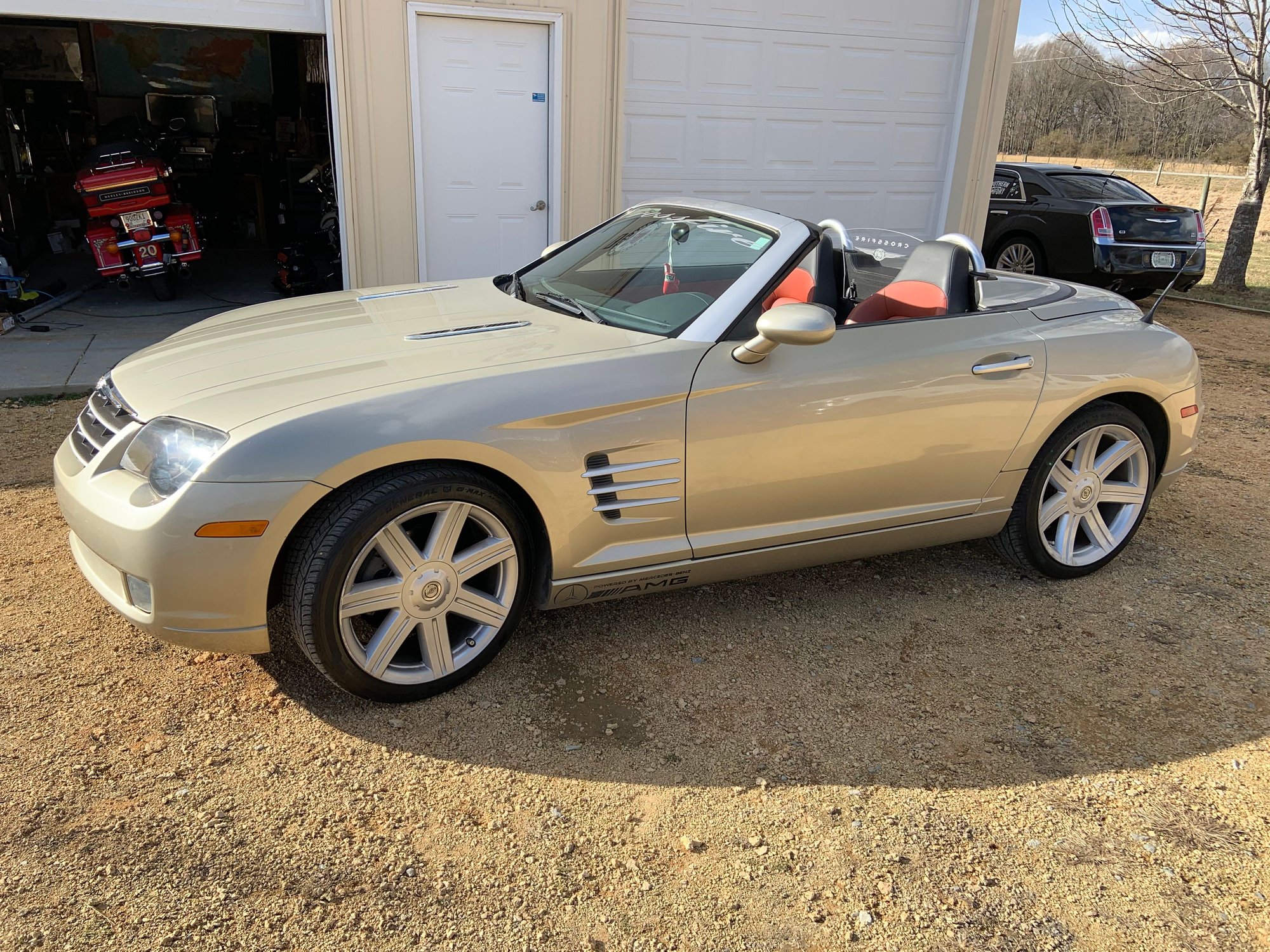

Hi all, name here is Ed, located in Tennessee and i just acquired a 2008 crossfire, oyster gold roadster, manual shift, with 45,000 miles, one owner. So happy with my purchase! I first want to thank you guys for the forum and all the helpful info that's here.

car looks great , it is a fun car and from the vehicles in the pic u will enjoy it .
