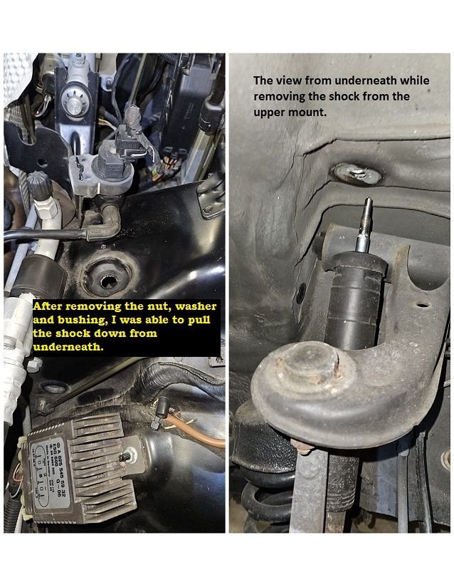

I replaced my shocks with a different brand than KYB.
I have included pictures from a post I did when I removed my old shocks and when I installed them.
There is a rubber grommet that goes on the shock itself. There is another thicker grommet that goes on the inner fender well in the engine compartment. I don't know if KYB installs the same as mine, but maybe the pics will help.

The way I did mine was I pulled the shipping strap to the side and put the first rubber grommet on. Then I compressed the shock and put the shipping strap on. I bolted in the bottom mount first. Then I cut the strap and guided the shock into the hole.
The problem with doing that with yours is the pressure as you mentioned.
