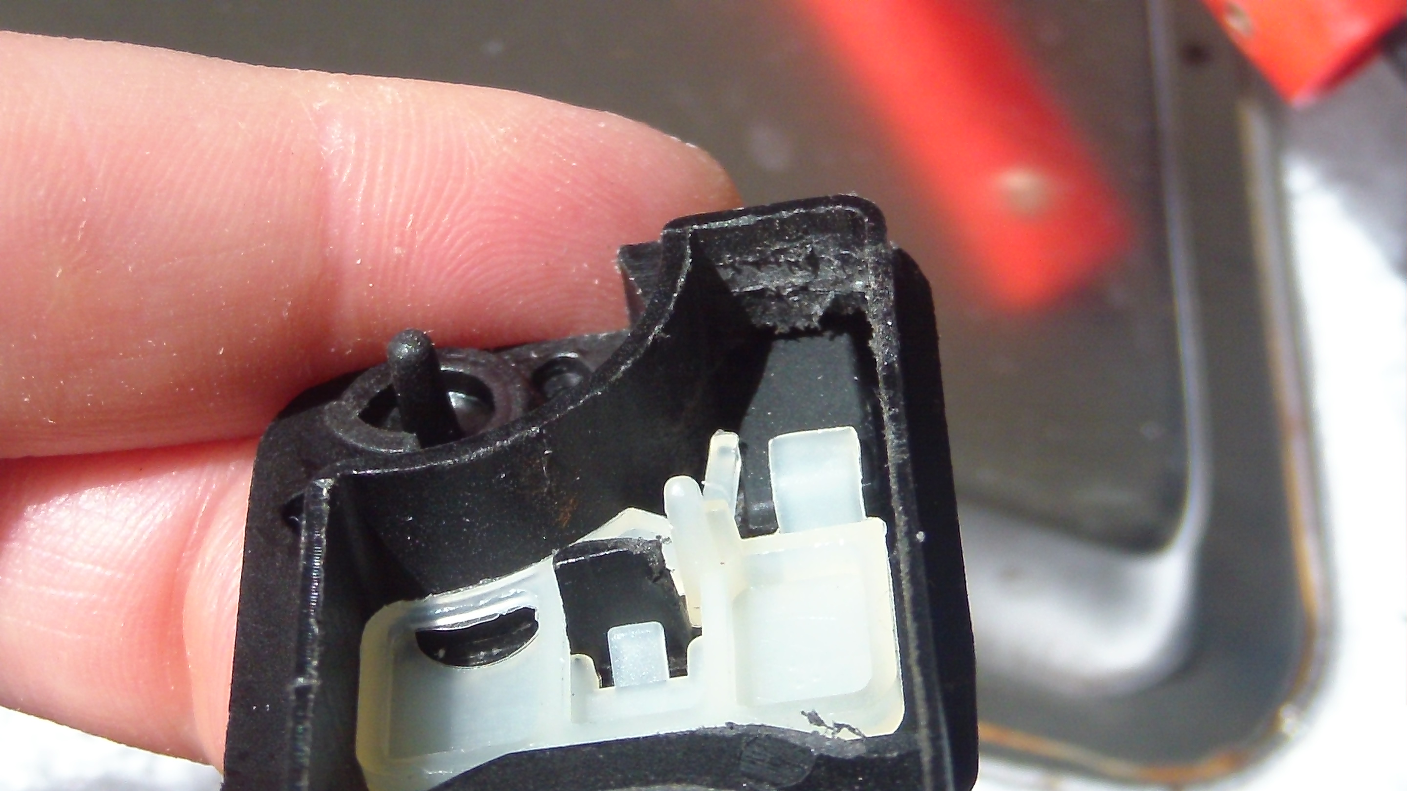

OK - so I finally got the new Key FOB I orderd from ebay Folding FLIP Remote KEY CASE Mercedes-Benz 4 Buttons - eBay (item 160518978310 end time Apr-12-11 07:28:28 PDT)
& swapped out the Guts form my old one that had a worn out panic button.
Although this FOB does work it takes a couple hours of Pain in the butt modifications so if you just want a quick swap don't buy this one, try one that is already the exact match.
I will elaborate on the modifications you will need to do if you do purchase this 4 button unit off of ebay. By the way the 4th button for opening hte trunk is not on our crcuit board so nothing happens when you push that button.
First are a couple of pictures of the actual Key FOB I received in the mail about 3 weeks after ordering it. Our key is the typ "A" version if you are actually getting a new key cut make sure you order that one. A has a square end and B has a point.
To remove your old guts follow the great post by tom2112 (thanks Tom) https://www.crossfireforum.org/forum...estroying.html
I did not have the special pliers on hand so I just used needle nose plyers but there was so much epoxy that it deid break the shell of the old FOB and when it let loose the parts flew all over (lucklie I found them all and no damage).
See my next post for the rest of what I did to make the MB Fob work.
Attached Thumbnails WTB: Key fob for xfire-dscn5737.jpg   WTB: Key fob for xfire-dscn5736.jpg   WTB: Key fob for xfire-sam_0079.jpg

Yeah I got mine the other day and attempted to make it fit. It is not an exact fit by any means. Numerous plastic bits have to be removed and the key does not rotate properly. I wrote it off as a loss, unfortunately.

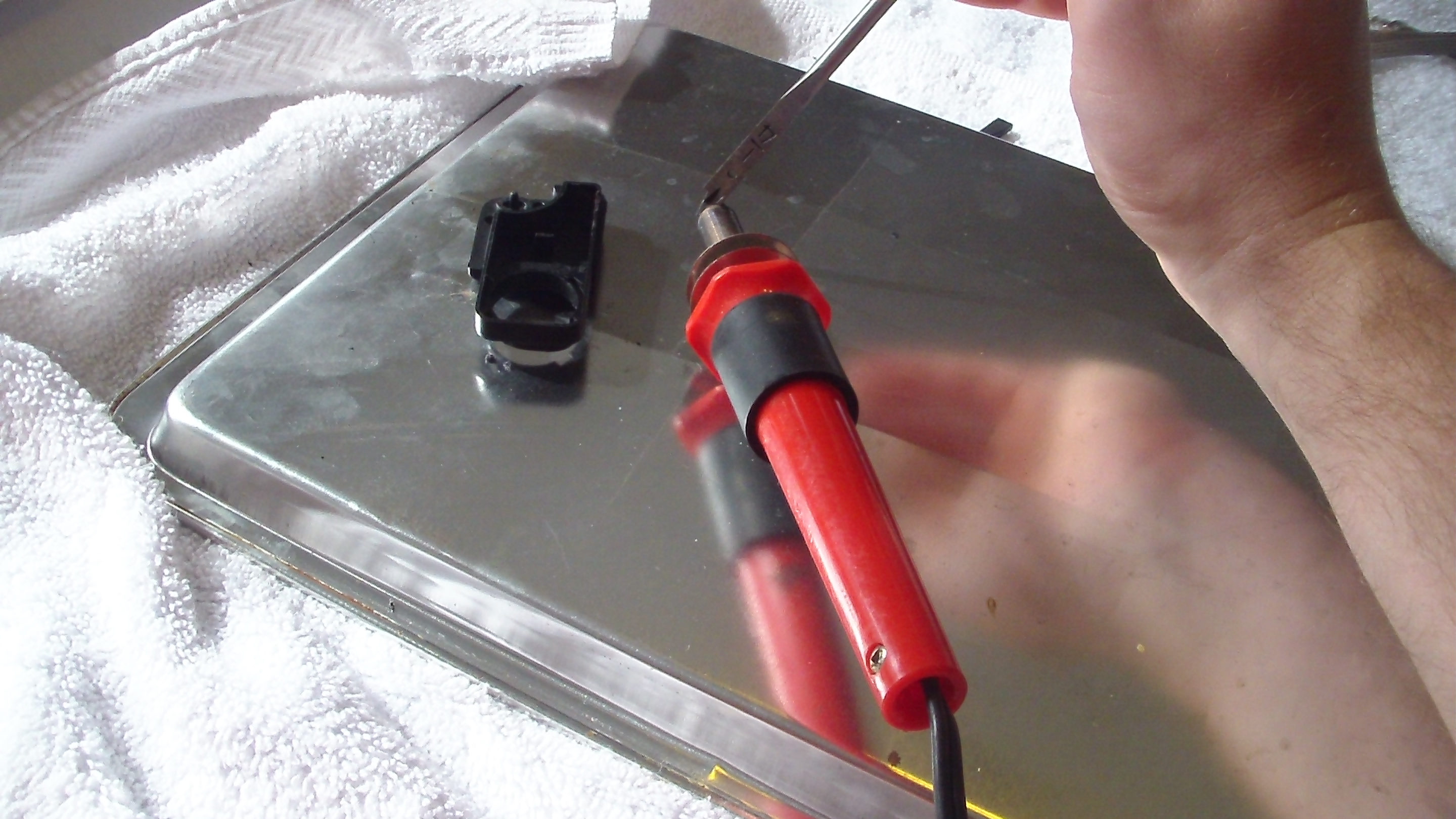

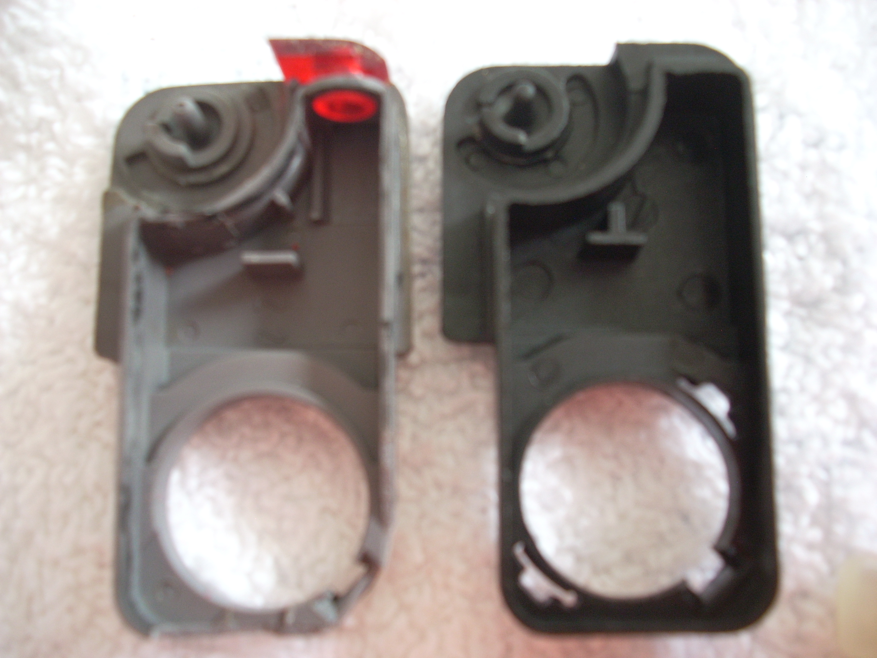

OK so there are some differences as you can see by the pictures of the MB FOB vs the original.
There are differences in both the plastic case and the metal key part that need modifying.
The first difference and obstical is the original plastic back has a single tab for the white piece to fit over and the newone has a T shaped tab. I cut the tab with a razor knife to allow the white piece to fit properly (see pictures).
2nd issue in next post

The 2nd problem is the original plastic back has a slot cut where the transmitter fits into (little black chip that your computer recoginizes and allows your car to start). The New MB FOB doesw not have this slot in the plastic so I had to guage out the slot. I did this by heating up a sharp hole cutting drill bit to easily carve out the square I needed untill the transmitter would fit into the slot and the white piece could fit in all the way down properly.
See next post for mods required to the metal parts.

Old Apr 17, 2011 | 07:34 PM
bluecoupe's Avatar
Posts: 3,140
Likes: 83
From: Grimsby, Ontario
Default Re: WTB: Key fob for xfire
Nice write up, thanks. I like the black case much better than the grey.
