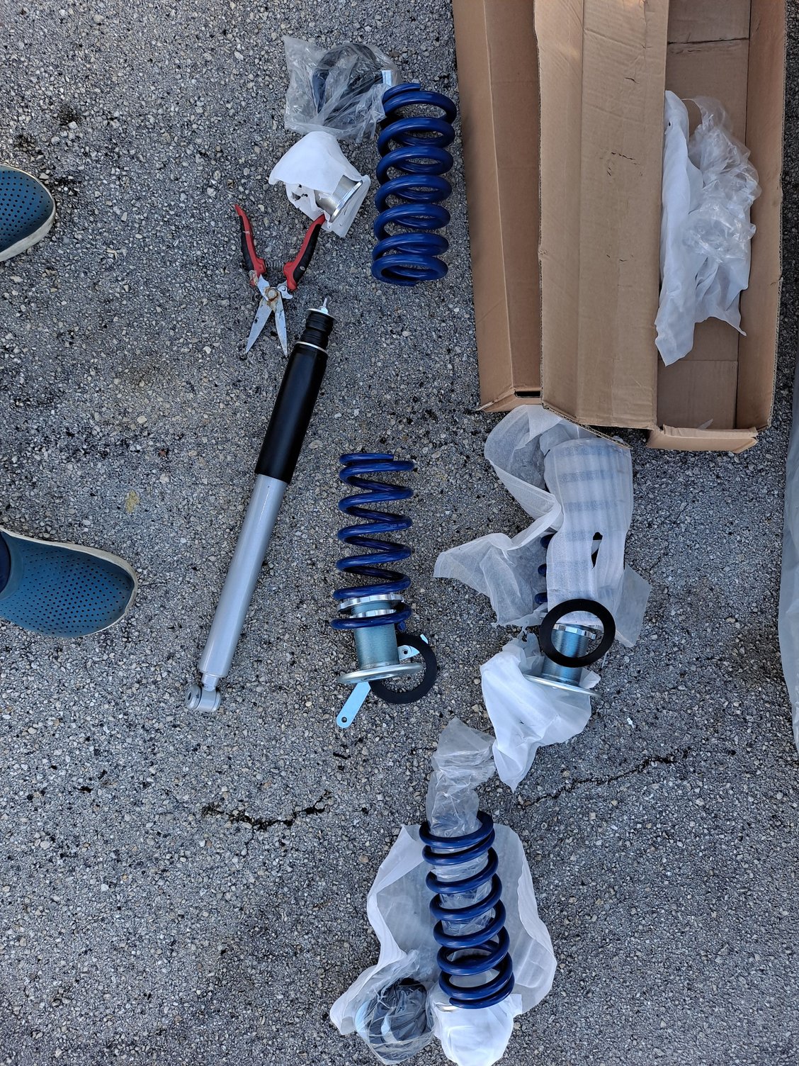

This is the cheapest coilovers on the internet. JOM from Ebay, about, $400. I want to keep my adjustable koni struts but use this height adjusters and springs.
There were no instructions,. How do you put these front ones together?
