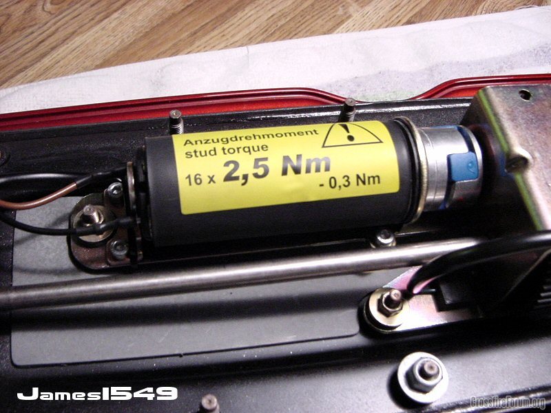

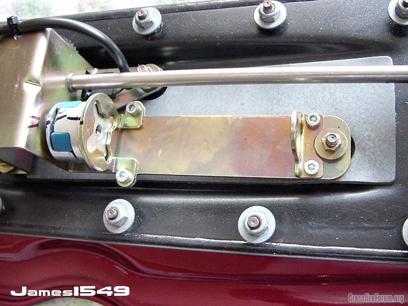

Once you remove your active wing assy, remove just the motor from the assy (about 5 minute job). Replace all screws/ fasteners back where they belong so if you decide to go back with the active wing, you will have all the parts.

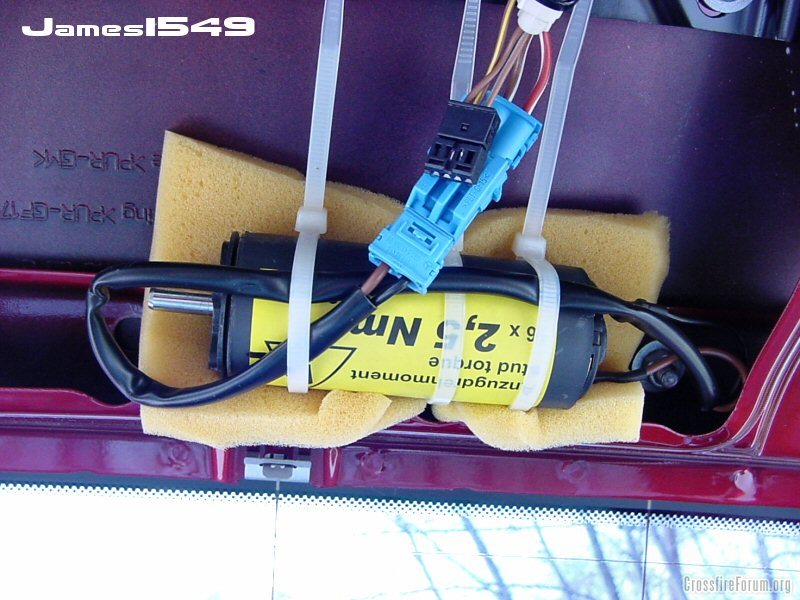

I partially wrapped the motor in padding and installed it using wire-tyes as you can see in the pics. There are many ways to mount this, as long as the motor shaft is free it will work. I found that the motor must be connected in the circuit so the BCM can read a signal to be sure the motor is present and within working range.

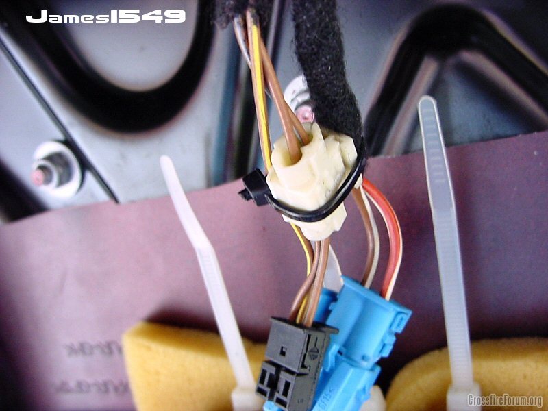

Next I had to wire it so the BCM had a signal that the "up limit switch" was activated or closed. The easiest way I saw to do this was to use a Tap-it connector. It is not in the outside elements so it should be ok. I know there are better connectors. You decide how you want to do it.
