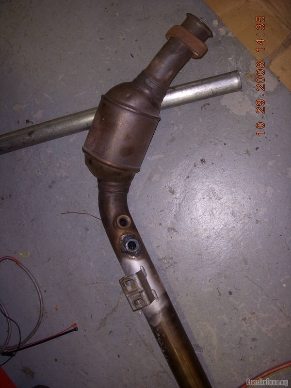

I did mine per ROB just after the stocker ON THE SIDE to keep soot and water from getting into the sensor. AFter the cats is wrong to me, just saying.
https://www.crossfireforum.org/galle...edium/0282.JPG

Woody, your pic shows it AFTER the cats, but you say you disagree. Is this pic of someone elses pipe (what not to do). Confused, cheers

Well smack me down, your right. Between the cats is where it goes, next to the factory one. You get old and you forget what you.
