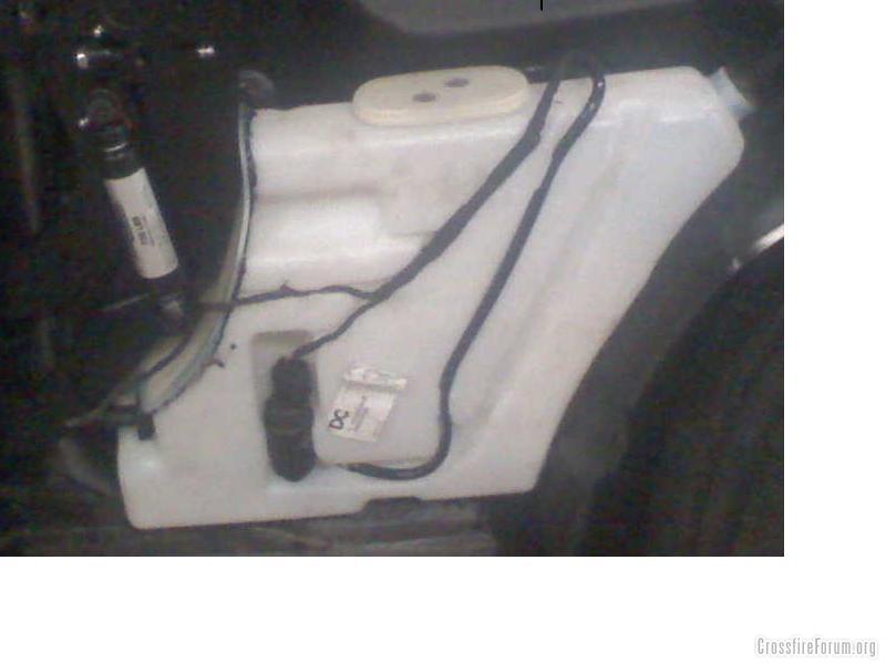

I just got my 2004 XFire on Friday, and discovered today that the washer fluid jets don't work, which kind of sucks. It's at the dealership right now getting the brakes tweaked (hopefully that'll solve the BAS/ESP light, but that's a different story). Anyway, I let the dealership know about the jets, but was wondering if anybody else has ever had the same issue. And by the way, I just refilled the washer fluid because I thought that was the cause, but it wasn't. Thanks in advance!

I am not sure what "tweaking" the brakes involves, I would be curious to know.
As far as the washers, can you hear the pump run when you try them? Have someone stand by the passenger fender while you try it and listen. If you can hear the pump run, maybe the nozzles are clogged. If it isn't running, maybe a bad pump, switch, or connection.
