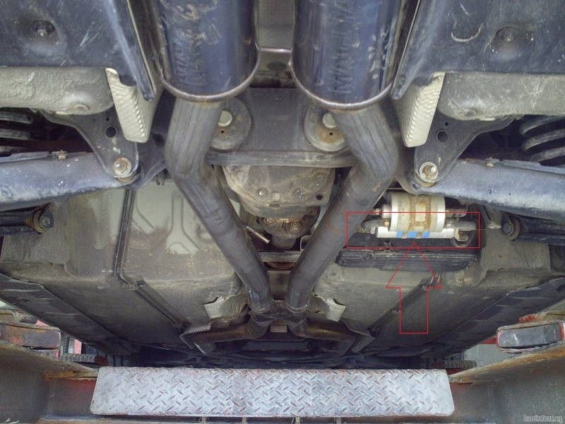

Good morning AZ Outlaws;
Did you ever get this remedied?
3 years ago I replaced my fuel pump; if memory serves me correctly. it simply died.
Now, like you, three years later, I have a noisy fuel pump. It comes on like it should to pressurize the fuel line, then gets loader based on fuel demand. It never stops running. It is not the rear end, it is the same noise when I am stopped at a light. A constant Hum...
I believe these pump have a built in Pressure Regulator. If so, I need a new pump.
thoughts? - D

I didn't realize that my strings were overlapping, I have not found any relatively good answers for the Noisy Fuel Pump. But since my Post, I have absolutely verified the humming noise on my vehicle which I believe others have heard, was the External Fuel pump. Easy access and easy swap out..
Simply remove the fuel pump Fuse, crank the engine to relieve the fuel pressure, remove the plastic pan under the car, clamp the Hoses, detach the electrics, remove the hoses, unclamp and replace the canister, and reverse the order.
Just wanted others to know.
