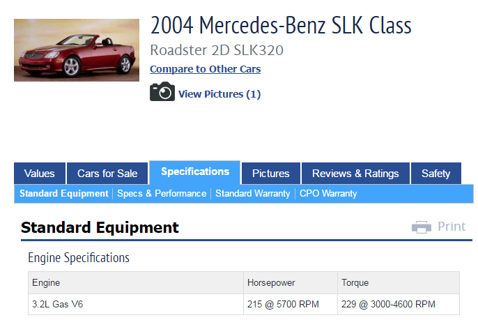

Same is true for the M112 NA engine, is it really 215 HP as stated by Chrysler, or is it the same as the SLK320 at 230 HP ?
Old Jun 12, 2016 | 07:25 PM
Likes: 650
Default Re: Performance modification limit? (non SRT6)
Where is that 230 coming from? For hp the 218 figure is the common hp found for the SLK320.
Gotta change the stuff I'm smokin ! Yer right Dave : ( from NADA Blue Book )
