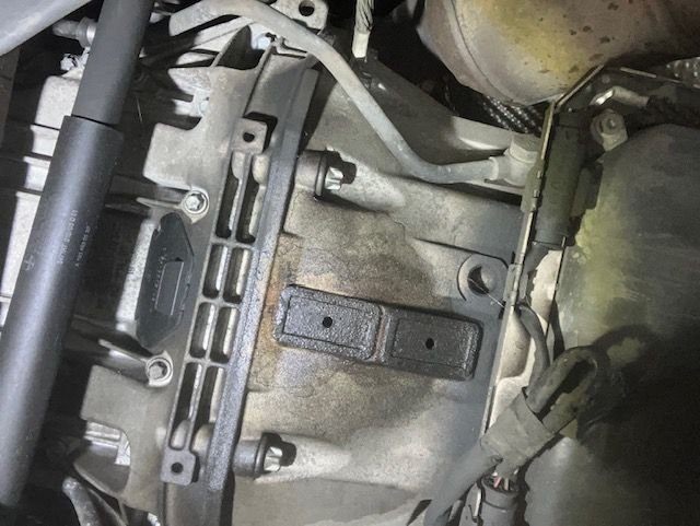

I am getting ready to do the fluid change and spotted seepage from these two rectangular plugs just ahead of the transmission pan. Help me as to what is going on here and how to stop the seepage.

that is a leaking rear main crankshaft seal
OUCH!!!! Well, it is seepage and not a drip as of yet. A time bomb with a long fuse
