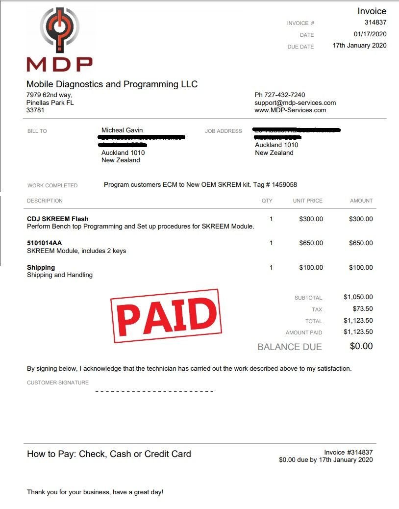

I sent my SKREEM, ECU and 2 keys (from New Zealand) to MDP in Pinellas Park, FL for repair.
They spent a couple of days on it but discovered my SKREEM was unrepairable.
Luckily they had some OEM and keys available and they re-programmed these with my ECU.
VERY good communication. I was kept up to date regularly via email and payment information was via a phone call and an Invoice supplied
Justin told me that MDP had purchased (a while ago) as many OEM SKREEMs as they could get their hands on but that numbers were reducing. (7 left)
After these were gone, they would be unable to offer replacement SKREEM
Today I am waiting for the reprogrammed SKREEM etc to clear NZ customs.
I will provide an update once I reinstall, but am confident
After these were gone, they would be unable to offer replacement SKREEM modules
I was under the impression that MDP repaired our own SKREEM modules and returned the same one back in working order
Are you saying they are replacing our SKREEM modules with a different module than we sent to them if they can't repair the one we send ?
By my way of thinking, if the SKEEM any of us sent to MDP for repairs was identified as not being repairable, the only alternative we have would be to get a new SKREEM configured plus keys. At least that is what I thought Mike G stated in his post. And this could be disappearing in the near future with lack of SKREEM availability. We already have issues getting new/additional/replacement keys.
Sounds like all of us are driving cars that will leave us stranded sometime down the road because both Chrysler & M-B are abandoning these cars. This issue alone really influences my purchase of another Crossfire. I realize that there are many car marques out there that have long been abandoned by their manufacturers. But in the case of a source for a new programmable SKREEM module (which is critical to operate these cars) disappearing from the marketplace, it is somewhat risky to purchase another Crossfire - MHO. I probably follow this thread line more than any other on the Forum.
