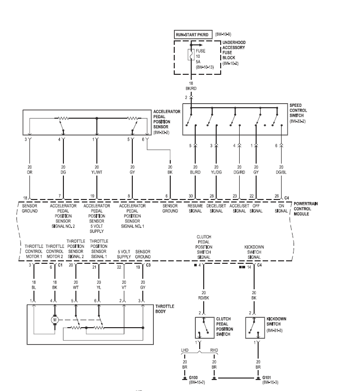

Default Re: High rpm idle
I did do the throttle reset. If I'm not mistaken we dont have a throttle position sensor, but you're talking about the accelerator pedal sensor?

The only thing my OBD scanner is showing
Yes, I meant the gas / accelerator pedal position sensor.

AFAIK, the throttle position sensor sends a signal to the ecu. The ecu interprets this signal, in turn operating the throttle body. You've already replaced the throttle body, and mis-interpretation of the signal by the ecu is reasonably unlikely - leaving the tps?
The TPS IS the throttle body ! It is a resistive strip on a circuit board inside the black cover.
