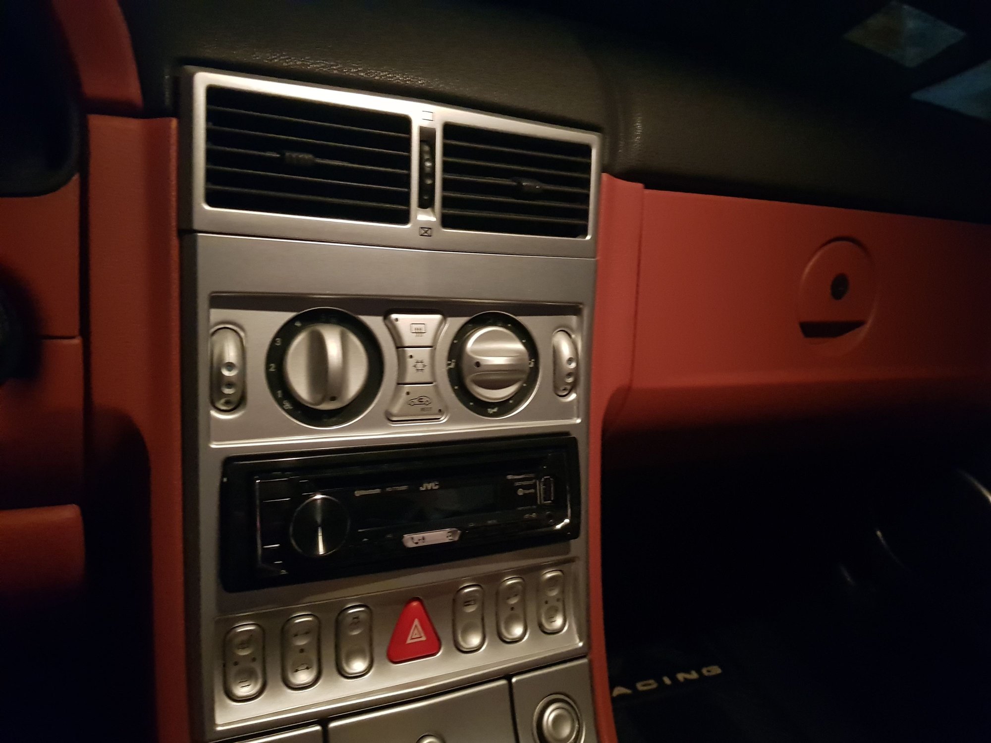

HI again people. I had a problem with my Xfire a few months ago, I turned the car and I had smoke coming out the AC vents, the one in the middle (top of console) and on the left one (driver side). Everything is working fine with the car except a problem with the foglights that are not turning on. I have a spare light module to replace to see if this fix the issue with te foglights. I dissabled the whole thing inside the car (please see pic) because I want to find the problem and also I want to paint the interiors of the car. Did any of you have any idea of what this problem was? By the way, the AC, radio, center console, Air bags sensors, etc. are working correctly, I dont have dash lights pointing or warning me any electric issue, my fear is to use the car and experiment the same problem again, by the way, the situation happened 2 times. Right now Im not using the car because of this and I dont a mechanic in Puerto Rico willing to work the eelectrical problem of the Xfire.

Well. Finally after more than a year I have replaced the part that was causing the problem...the module that controls the lights was burned..the one on the left of the steering wheel..for some reason it was damaged maybe by a cable ralated to the music equipment or the aftermarket fog lights, but that was done with the previous owner not me. I replace that module and fixed the music equipment, replace the radio and everything was verified by a MB mechanic. I was having problems with the exteriors lights and thus was resolved with the replaced module. After nightmares finding inside parts on ebay I put everything together..also the interior color was changed cause I have the panel doors in the same color. I just have to change seats color..maybe next year. The color was custom made for the car and I put an used module from e bay but practically new. Also I replace the steering wheel with a black one and the broken cup holder was removed. Let me tell you that is basically imposible to put everything back together and not break at least 1 or 2 tabs or some plastic.. it is a living nightmare..I also ordered a few spairs parts just in case. Thank you for your help people. ..let me know any comments good or bad. Still working on a few things.
