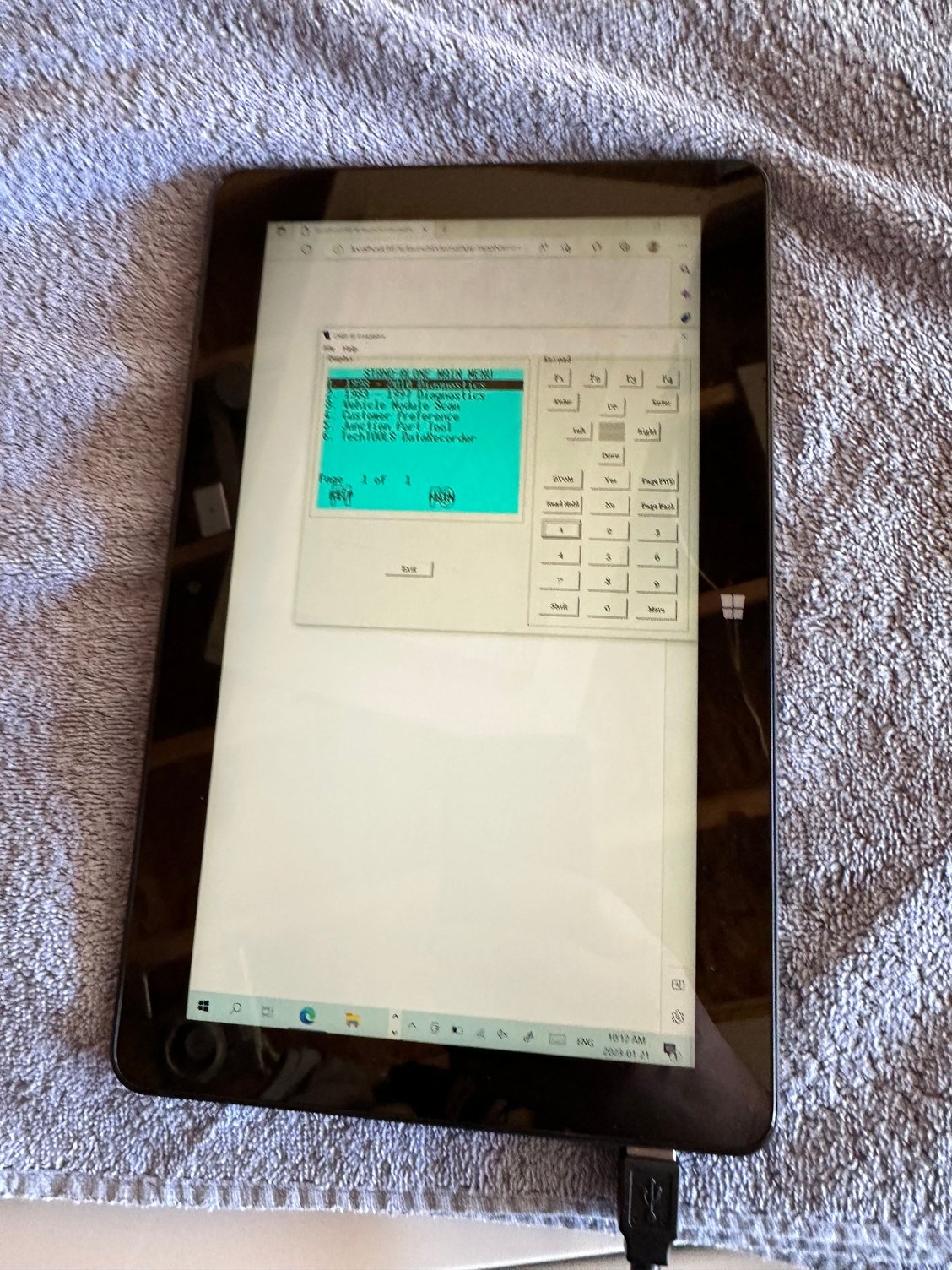

Ok. One more update. I’m goal was to come up with a real compact solution that I could travel with
Local buy and sell (Kijiji) Dell Venue 11 Pro 5130 $40.00
Win 10
32 bit
intel Atom
“tablet” with optional detachable keyboard
loaded the adobe air for 32 bit and followed all the steps
it worked
super portable table with 9 hour battery life
BEST PART IS THAT THE TABLET IS A TOUCH SCREEN. Just press the DRB button no mouse required. Size of an iPad. Perfect tool

Update on my experience installing the emulator on the Dell Venue 11 Pro tablet .... it works!
I used Windows 10 Home, 32 bit OS and all the files on the CD/DVD included with the device. Apparently, there is already a digital license installed on these devices, which originally came with Windows 8.1 so I just needed a bootable Windows 10 media and the Windows 10 drivers from Dell's support website.
A couple of odd things occurred during the emulator installation steps which are worth noting:
After installing the DRBIII Emulator stub, I was prompted for and successfully installed the updates. I seem to recall getting a 404 error the last time I did this, which told me the servers were no longer responding.
During the update process, it also installed the Enhanced DRBIII emulator stub.
Apparently, it was a newer version than the one provided on the CD because I received a warning that the newer version was already installed, so I skipped the step of trying to install the one provided in the CD.
Installing the K-Line stub went as expected.
So, it all just worked and I'm very happy to have a compact solution that I can easily take on the road to help other XF owners in the area.
Thanks for the hint, UrbanE !
